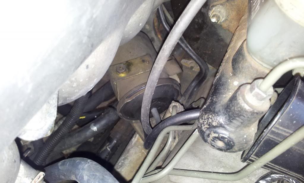

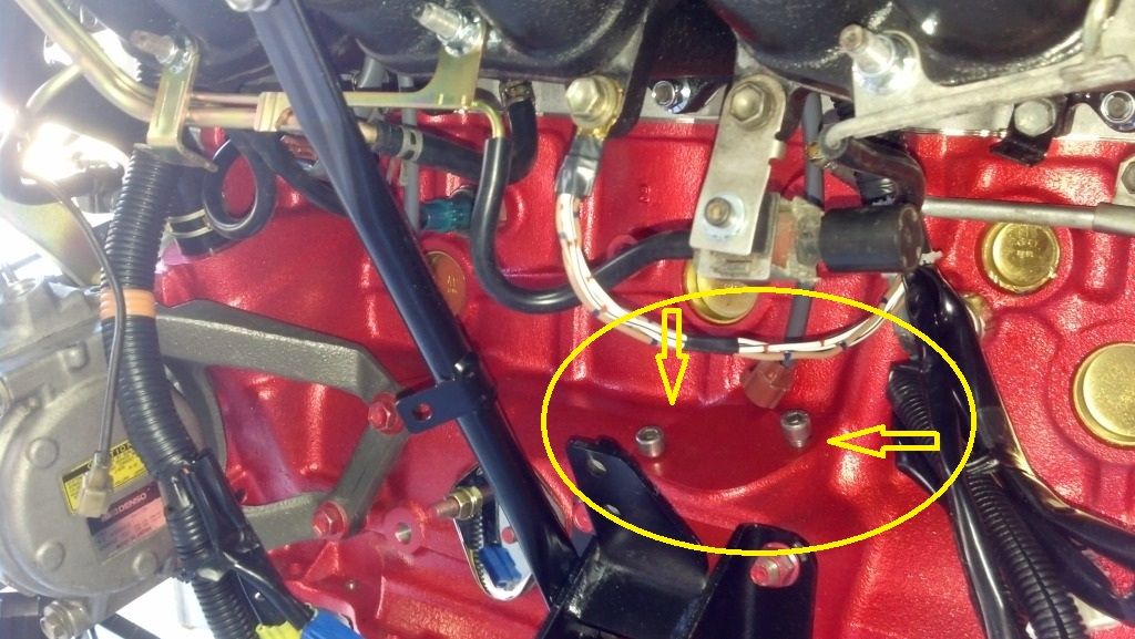

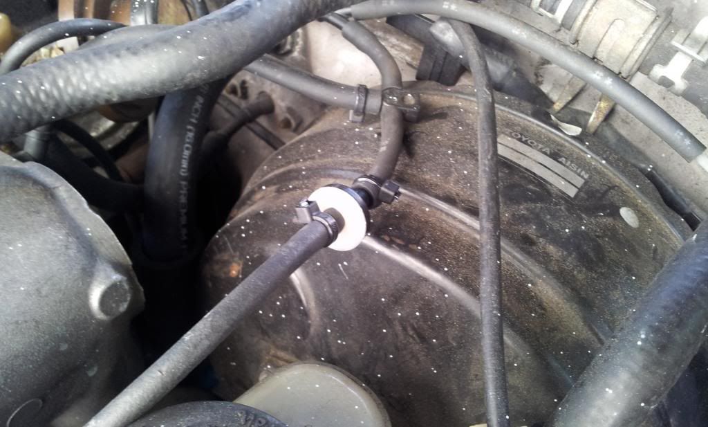

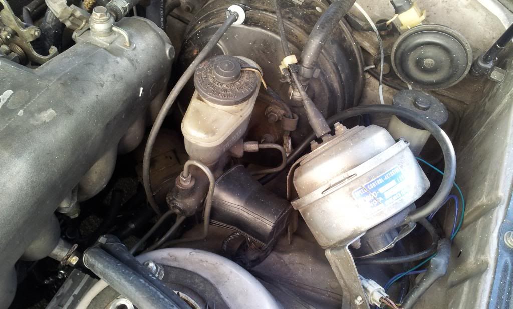

After digging through my parts bin, I found what I believe to be a ACIS vacuum canister. I found a tidy place for it under the intake manifold, hooked up the hoses, and installed a one way check valve.
I noticed with my hand pump that pulling a vacuum of 20inhg took 30 to 40 pumps which seemed promising.
After finding a highway with a steep enough grade for about a half mile, I tested the system and it performed flawlessly! The whole time up the hill was hovering about ambient pressure and CC was consistant!

Well that was an easy fix. Apparently the CC actuator's size and valve design (low loss 20 hz duty driven proportioning) doesn't require a large tank volume. In hindsight the turbo system's tiny pump kind of implies that. On the other hand many Toyotas employ an all-electric motorized actuator that would have made the problem nonexistent.

Well, I had been intending to utilize the acis can for this purpose, as it simply looked to be a vac cannister with a vsv mounted to it.
And suprasick- why didn't you mount it in the original location- do you have other things mounted below the intake manifold?
Wow... I didn't see you reply, sorry about that. The reasoning behind my mounting location was that the longer the hose the more of a chance it has to collapse under vacuum. I have already had one line collapse so I had to upgrade to thicker walled hose. Plus it's easier to get to :icon_bigg
