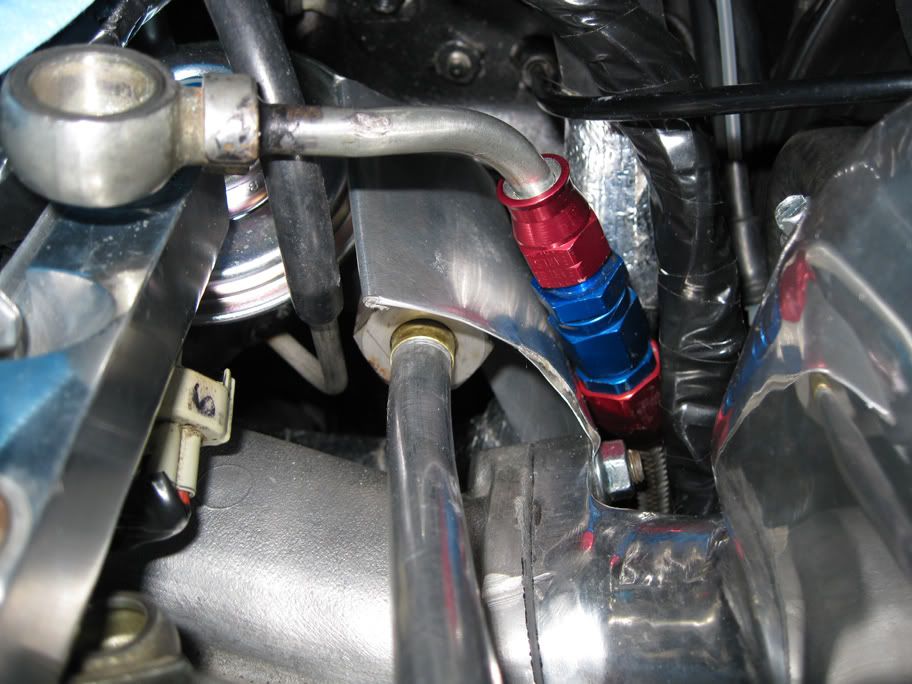

probably a verry simple question:
I've got a new fuel setup for my 1JZ (top mount injectors and an Aeromotive FPR) and I want to complete that with decent -6 AN fuel lines. What adapters do I need to connect these lines to the stock fuel lines at the base of the firewall?

-6 an to tube fitting, and a -6 an to hose fitting. That's how I did mine anyway.
