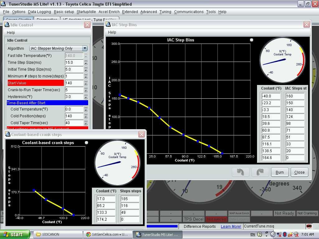

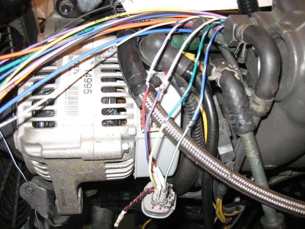

Nope! just mess with the megasquirt cold start enrichments and use the factory IAC valve to control cold starts.
If you don't know how to wire the IAC, then PM me, I have it all figured out
sweet! but i have looked at some threads on here about wiring it up as bipolar instead of unipolar so i think i got it but im waiting to assemble the megasquirt still. if i have any trouble with it tho ill hit you up! thanks man
Just in case

speedfreak426;1777063 said:
Just in case
sweet thanks a bunch! i cant wait to get this all together. im happy to leave the tccs behind
