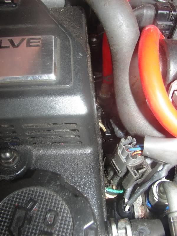

ForcedTorque
Join the 92 Owners Group
Jul 11, 2005
6,099
59
My head won't explode JJ....I'll just try to absorb. Once I feel the ear drums swell I'll change the page.
Meanwhile, I will contribute the best I can. This is the best picture I could get without taking the cover off of the CP. The ground wire in the picture is the white wire that appears near the vents of the cover. It actually comes out of a rise in the side of the cover, but you can't see that in this pic. It bolts down, after a piece of black tape to the stud with a nut on it. I believ that to actually be a one piece stud and nut. That is located straight down from the corner of where the chrome strip starts on the cover. It is a really short wire, and goes below the nut with a ring connector.
