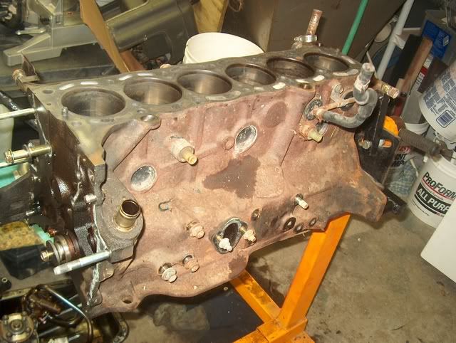

Crazy Question for you. If you look at the block from the Side that the Knock Sensors screw in. you Definitely know where the rear Knock Sensor hole is. and you see where the Front Knock Sensor hole is also. Question is what is that other Hole a little farther Forward but a Little Higher on the Block. Ive seen Knock Sensors Screwed into it before. Just wondering what that hole is for and infact it serves a Prurpose.

The knock sensors are inline with #2 cyl and # 5 cyl and the front sensors is slighty higher on the block than the back sensor.
Are you sure you have the front sensors in the correct spot?
