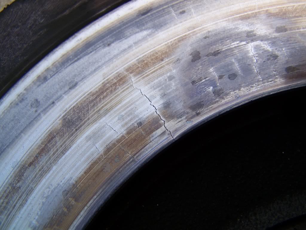

Stick a stock disk in there and turn the boost back down. One a clutch starts slipping you're on borrowed time and you're only risking major damage. Case in point (stock clutch that started failing the day before, tried going down the street and it slipped so bad I barely made it home)
Exploding flywheel isn't something I'd mess with (I like my legs)

Forgot to mention, that's the flywheel in that photo, but the pressure plate will get just as bad. The more you drive it while slipping, the more likely you're going to glaze/overheat/crack them.

Unfortunately I think I'm going to need a new flywheel. I know that after the fire (only a year of use) mine was toast. The heat fractures from the extreme aggressiveness of the clutch setup were extensive, though this could be in combination with the fact I learned how to drive stick on this car and clutch years ago.
