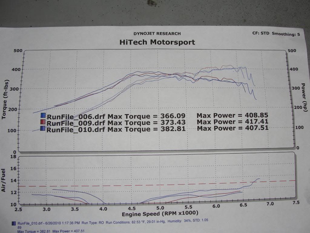

A guy local here (user name 92nsx) is runnign a sock PP and clutch disc at 408hp/370tq
here's his dyn graph with said clutch:
A lot is how you drive the car- Rob drives like a grandma and when he boosts he doesn't shift aggressively/no lift shifts. It wouldn't hold up to drag tyle launches for long at all :(
