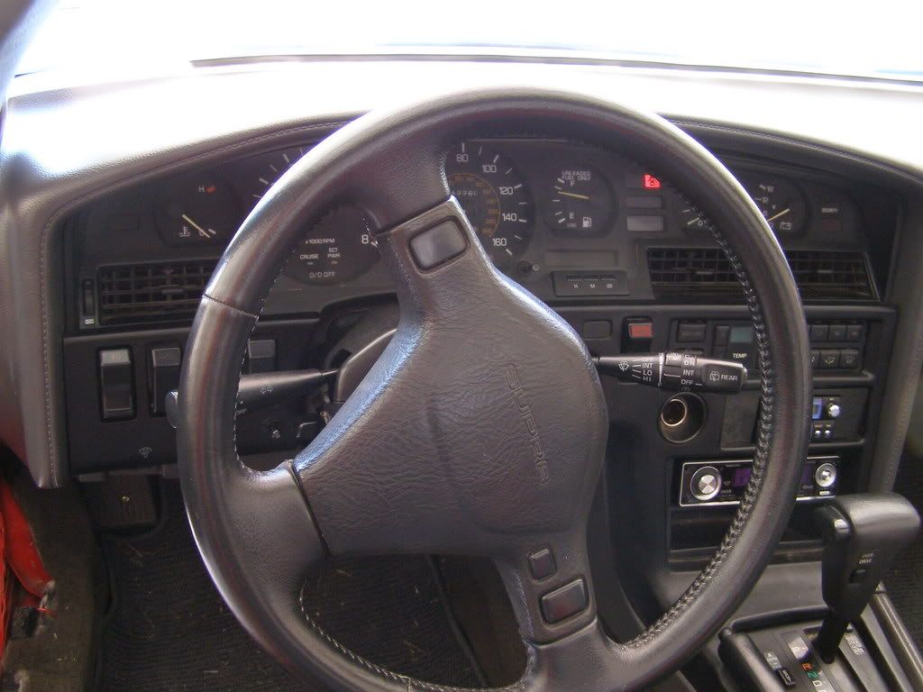

Steering wheel thread is here. I would put a nice steering wheel towards top of my list because I my delicate hands need nice soft leather. Of course if the car cant make it out of the driveway its all for not.:3d_frown: There are a few options here.
http://www.supramania.com/forums/showthread.php?t=64747
I love to have my steering wheel look like this only in navy blue or black.....
