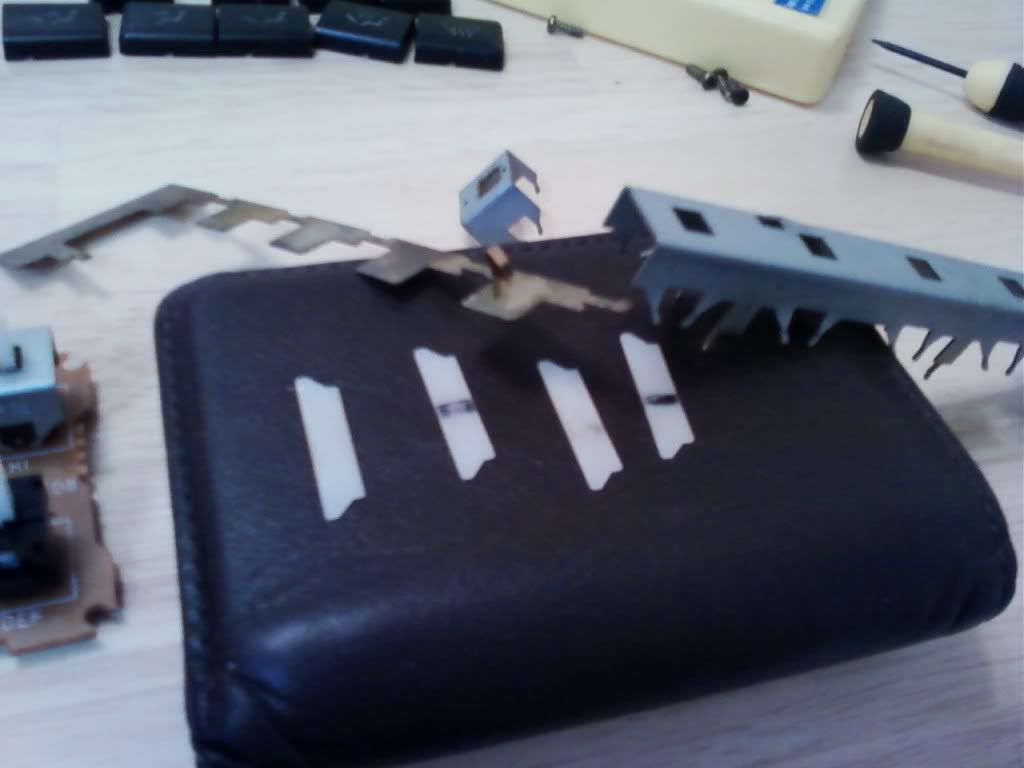

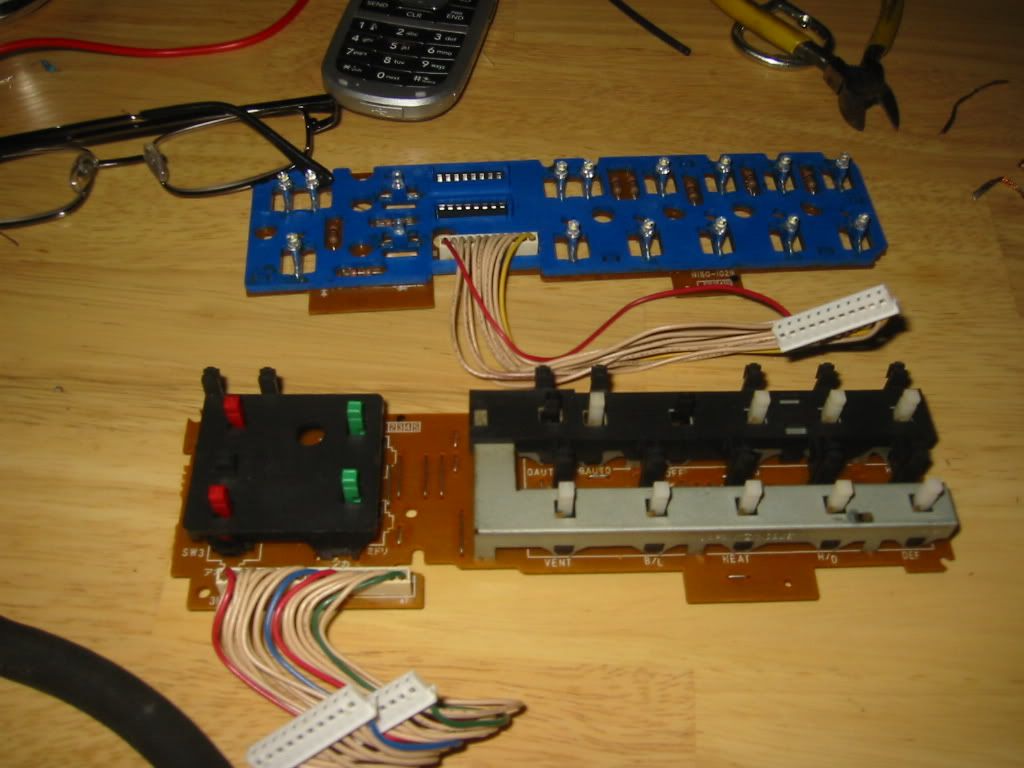

EDIT: Well, soon means now, since I was bored. Yep, it's possible to fix the buttons, but tedious as hell...
The repair isn't for the faint of heart as it requires near complete disassembly of one of the circuit boards. Took me about 4 hours of work.

The problem with the buttons no staying pressed in is due to the individual push contacts inside the unit. They are all topped by a stamped steel sleeve, which holds a spring loaded brass slide bar underneath, which has small tabs which in turn fit into plastic detents whithin each individual push switch. These detents round off with use, and are virtually impossible to fix. The company that made these switches no longer creates them(I emailed them- a company called Noble.)
It is possible to repair it by using a donor climate control. Since people hate the early model units, you can pick a few of them up and use the best push switches out of them. But as Poodles said- be prepaired for a world of pain. There are a myriad of small parts under that steel sleeve that pop out once you remove it.
