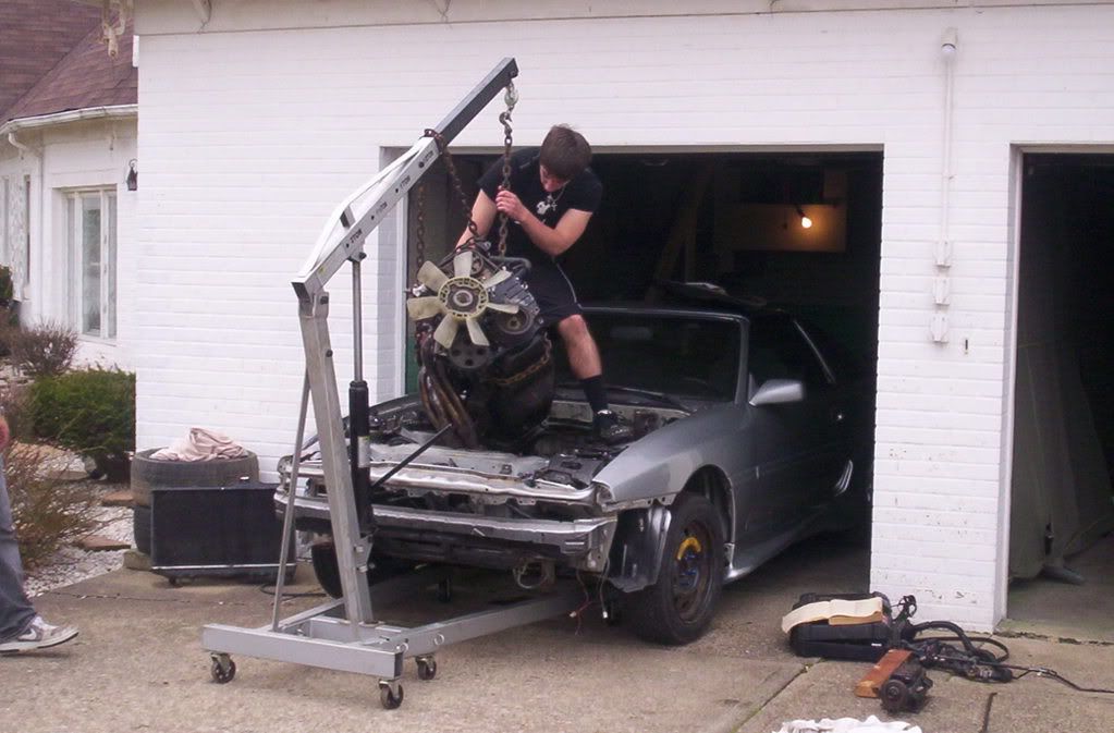

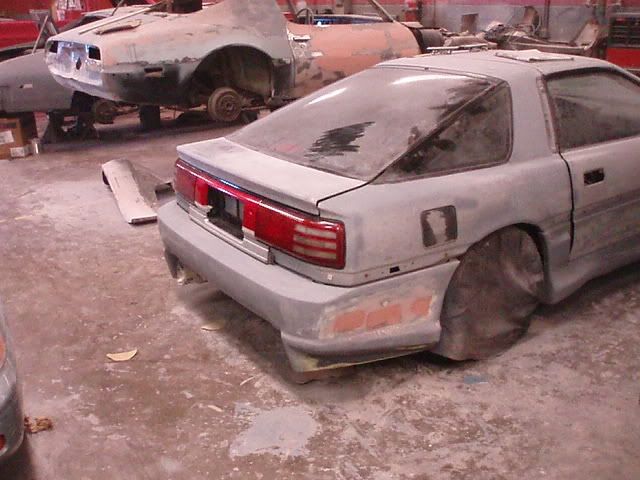

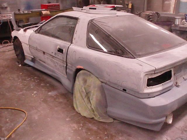

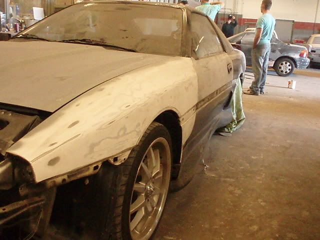

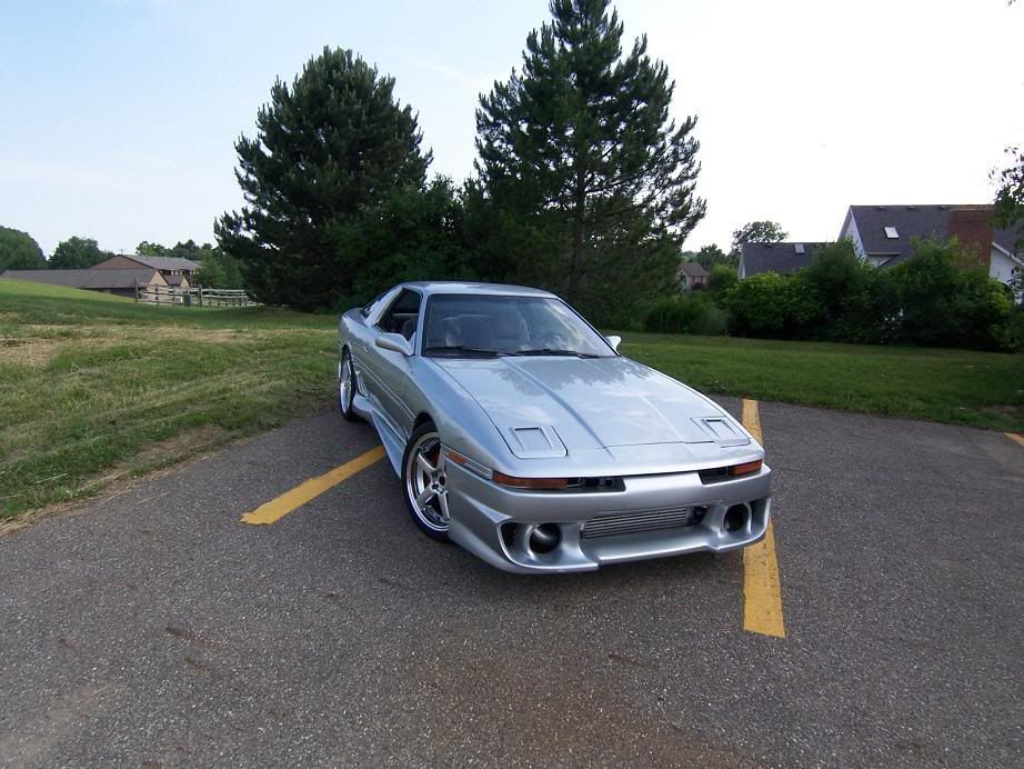

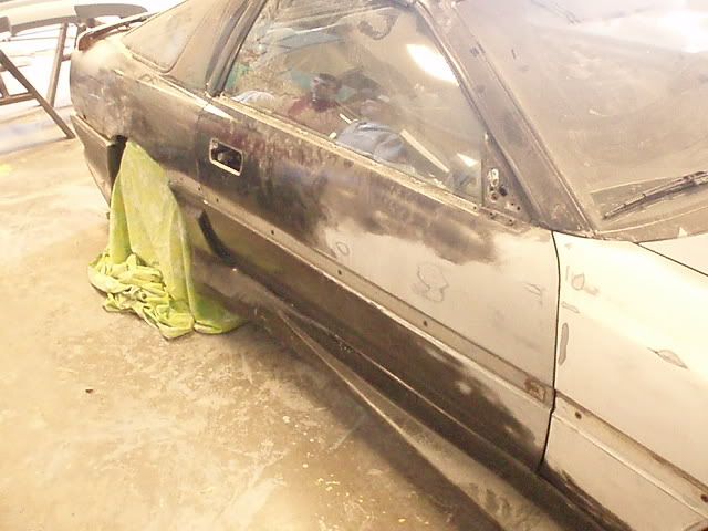

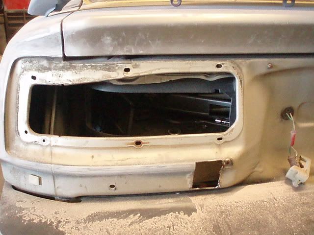

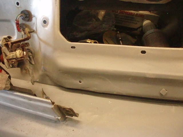

Here's the stages my car has gone through the last few months.
chuckmuska2005
Dec 3, 2007
265
canton

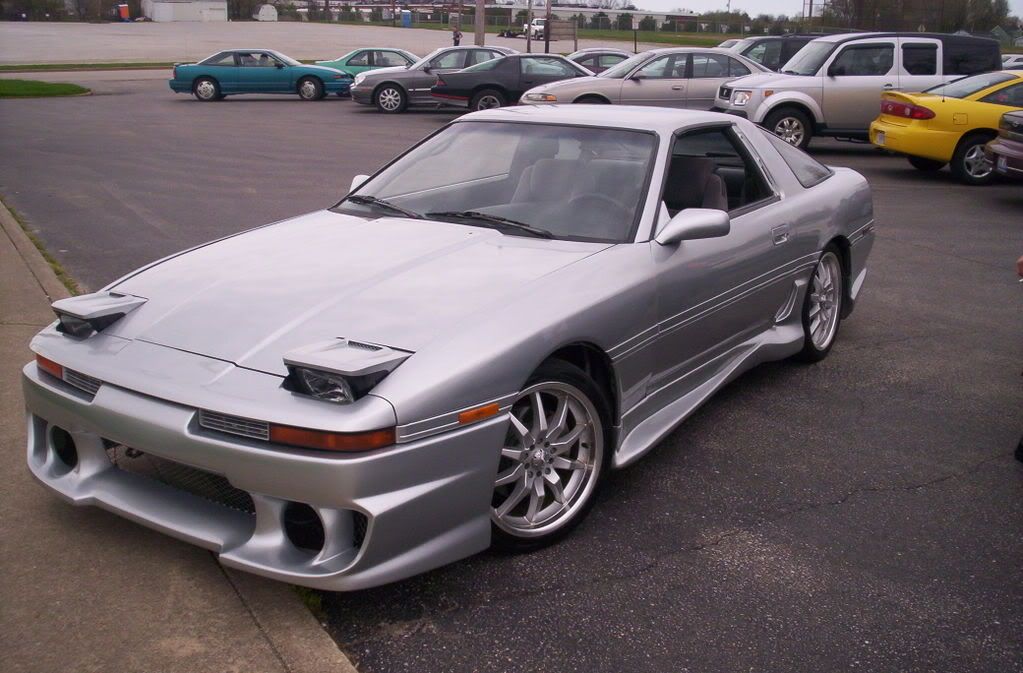

fonz87;1130323 said:

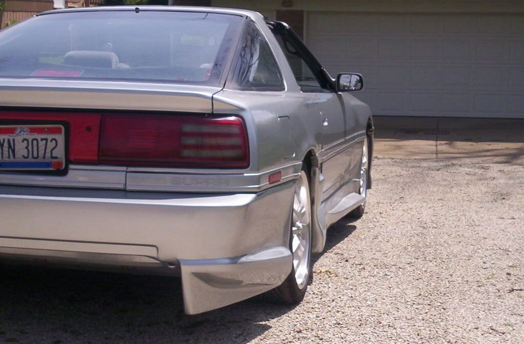

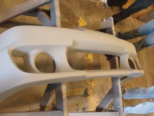

y the body kit ??

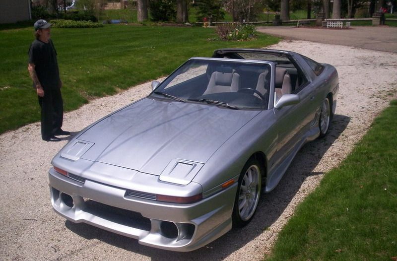

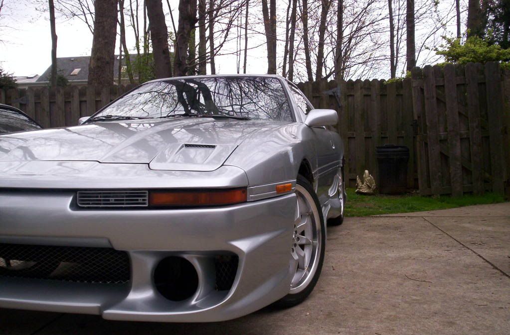

I wanted my supra to look different than a factory body that's lowered with aftermarket wheels. There are a lot of supras like that and they look good, I wanted to give it more of a stout look, rather than another supra with engine mods.

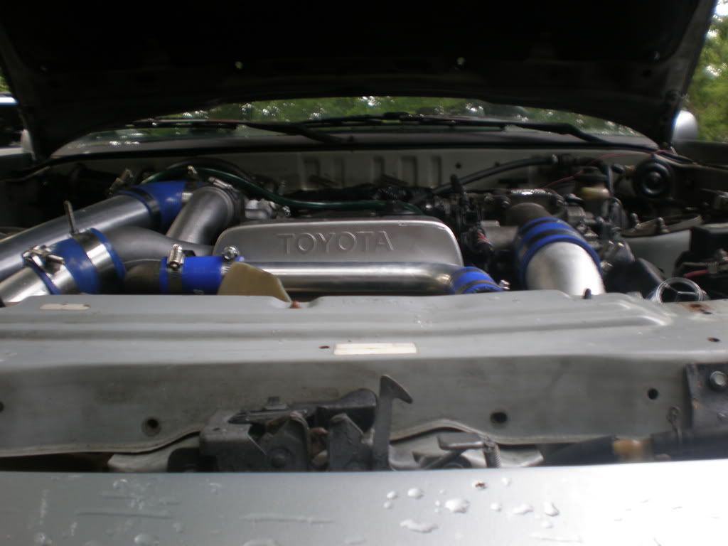

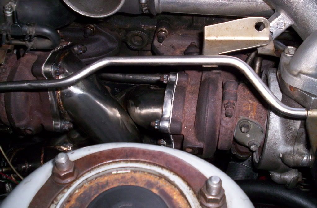

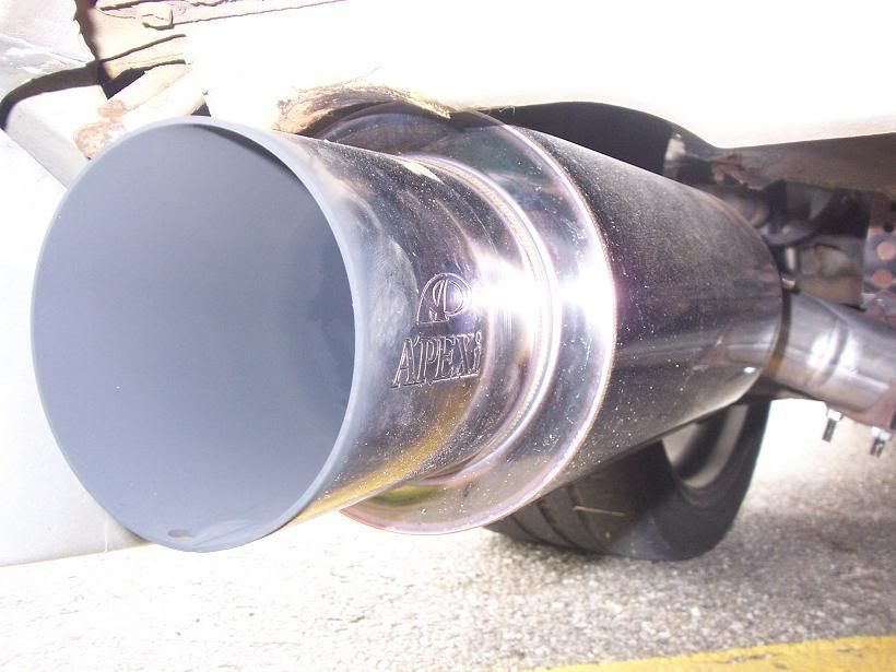

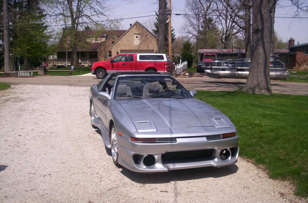

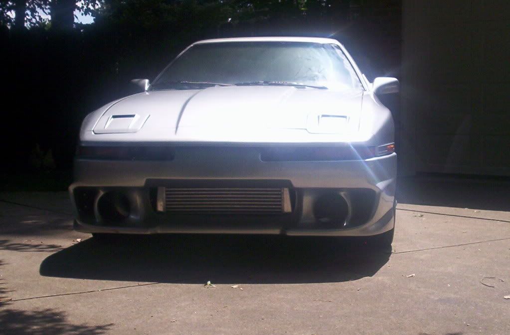

The current modifications list is the stainless y-pipe with 3" exhaust and Apexi muffler, AEM fuel pressure regulator, 24x12x3 aluminum intercooler with 2.75" aluminum hard pipes, SSQV and Blitz turbo timer all riding on Intrax lowering springs.

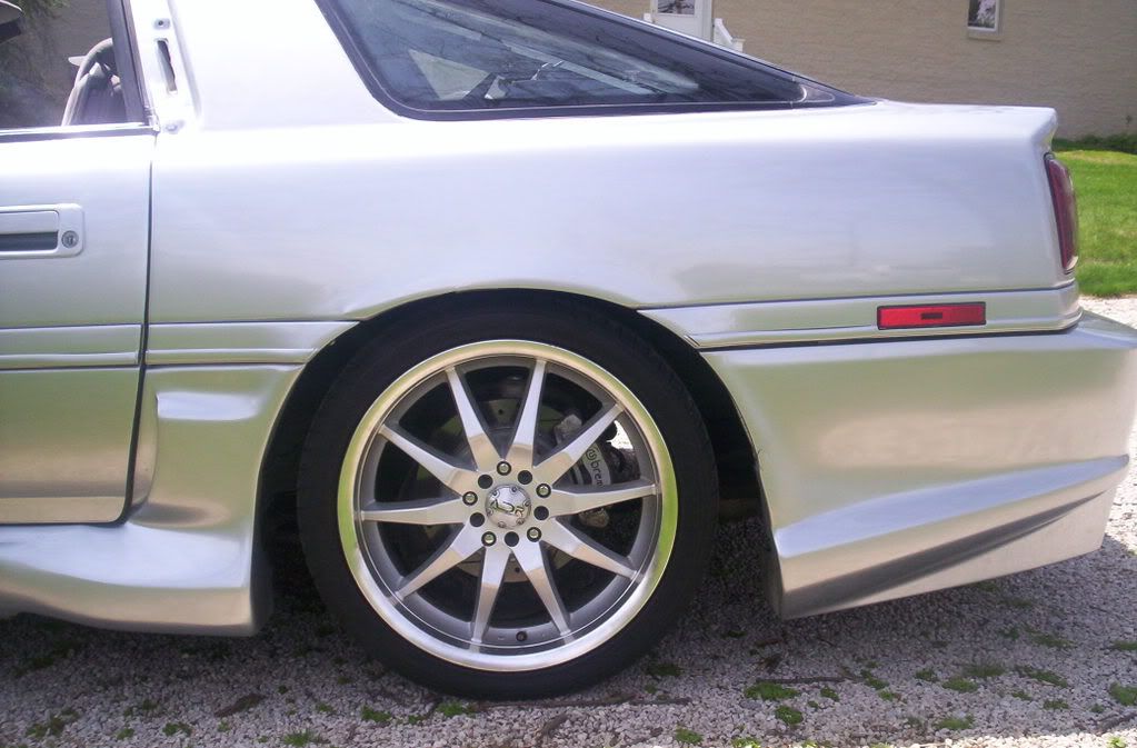

C1 outer

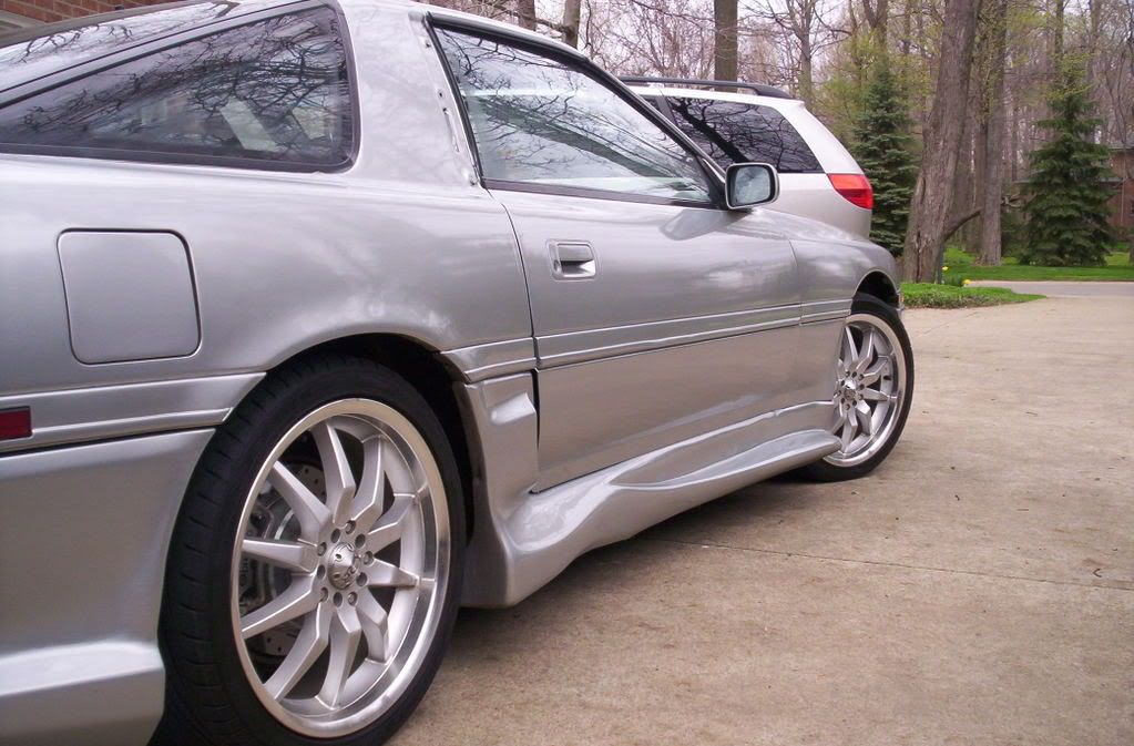

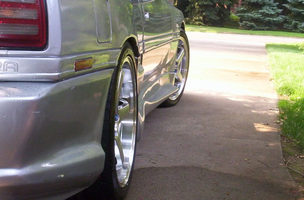

gtimportfanatic;1130772 said:
rotors are installed incorrectly..
what?? how can they be wrong, looks good to me. you can have the slots facing whichever direction you desire.
Chuck - Nice car. those rims are sweet. Only thing I'm not a fan of is the do-luck front, but it completes the kit nice.

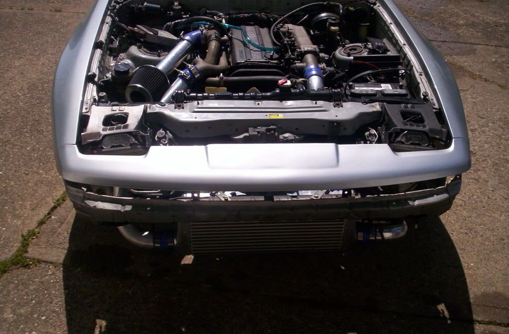

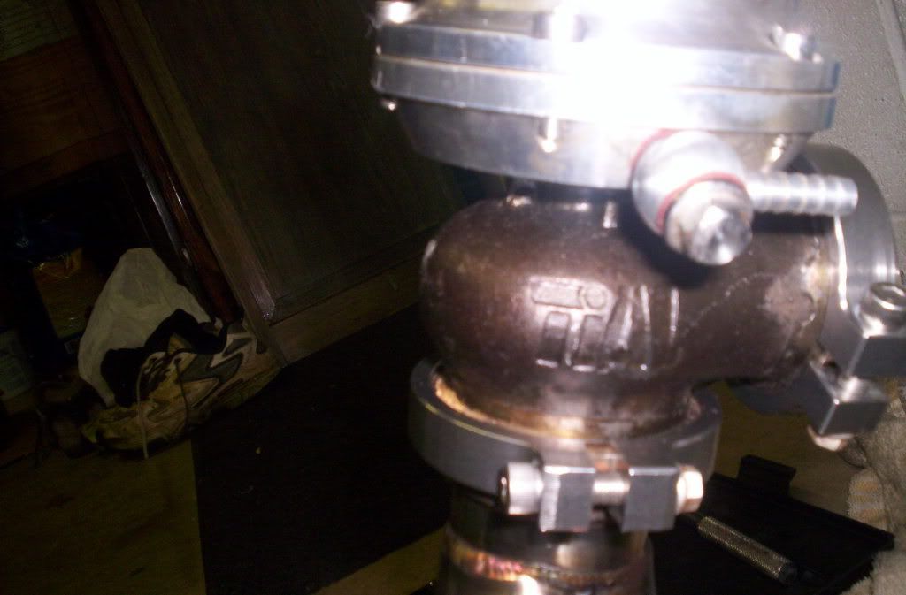

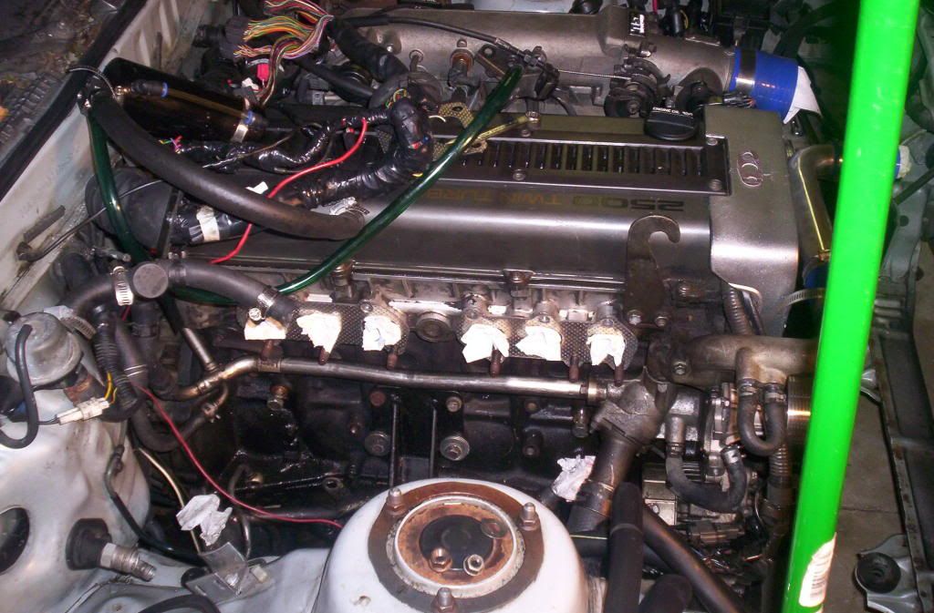

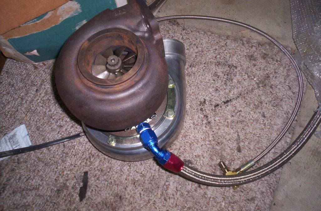

My new setup so far:
2jz 550's
jdm resistor pack
godspeed radiator with uppper radiator hose
gt45 turbo
tial 44mm gate
AEM AFPR
Apexi Neo
mobes
Supras are never 'done'
719
Bozeman, MT
The paint looks good. The kit really isn't my cup of tea, but it looks like a quality job. Those wheels are pretty sweet.
JDM resistor pack?
That GT45 :aigo: will be nowhere near its potential with 550's and a piggyback. Unless you have some lofty goals and plan to spend some serious cash to bring the rest of the system up par with that turbo, might I suggest that you sell/trade it for something a bit better matched to your goals. Unless of course you really really like turbo lag.
Don't forget to upgrade your fuel pump.
chuckmuska2005
Dec 3, 2007
265
canton

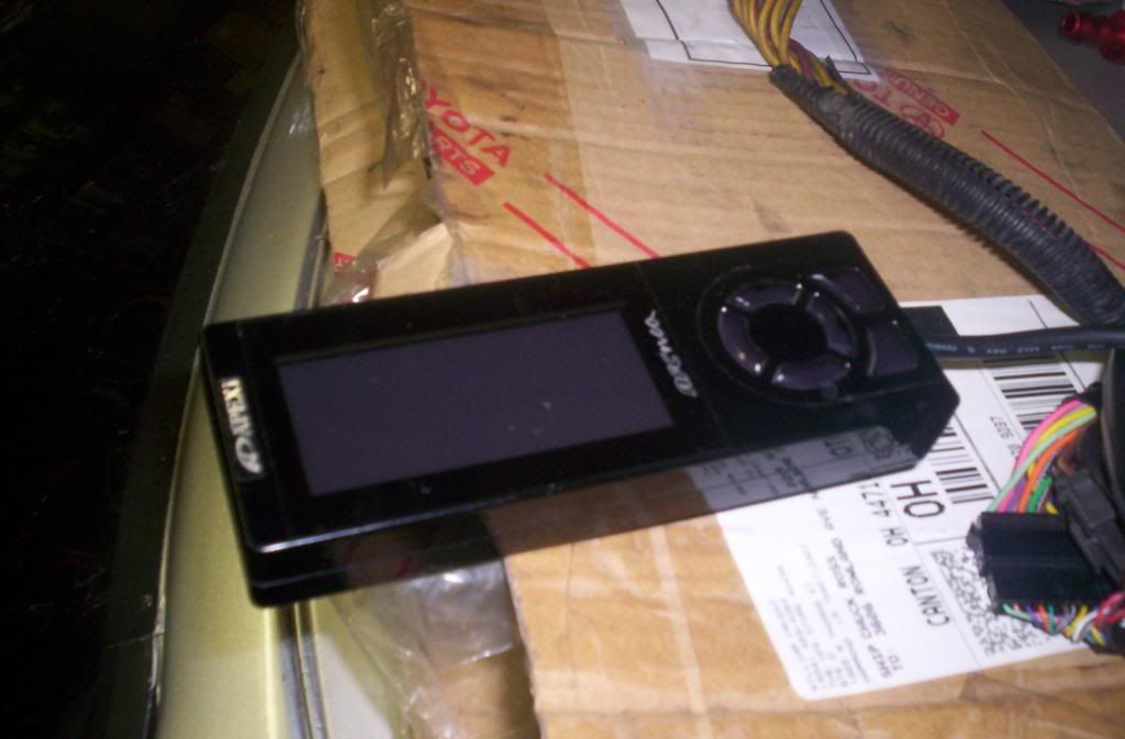

fuel pump and clutch are next in line. The resistor pack I ordered is straight outta Japan off of a Soarer. I had plans for a greddy EMU but thats up for next summer! :)
chuckmuska2005
Dec 3, 2007
265
canton
The setup will be fine. The turbo is going to have a natural lag being on a 2.5l engine. The EMU will greatly reduce that issue :naughty:
