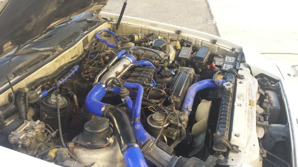

Under the hood is a birds nest the wiring harness is chopped and spliced 10000000 times and those splices are spliced as well. Too many hot heads trying to play at the fast and furious lifestyle. Every connector save a few are baked and cracked and there are tons of loose ends where connectors are missing completely. I definitely will need help cleaning up this mess first because the electrical is holding back all the truly awesome potential of this car.

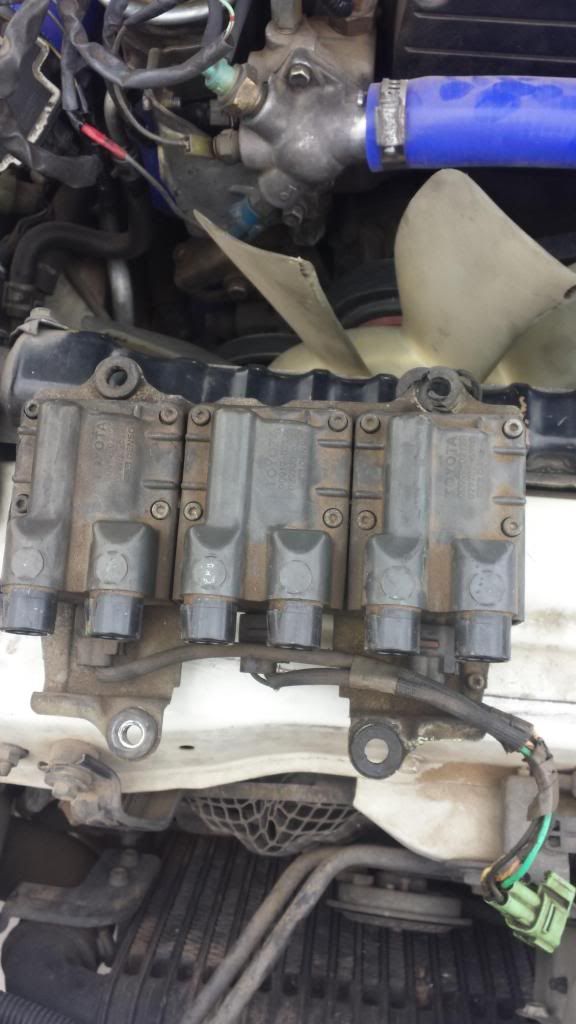

So far this week I installed new spark plugs and am waiting to hear back from a SM member about a plate to give Morganson's COP conversion a shot. I added all new fluids as well. Power steering, ATF, and coolant to find I am now losing coolant somewhere near the firewall. either a heater core line or something is leaking or cracked (hopefully not the head) but just to the driver side of the oil pan the coolant falls at a pretty steady rate. Going to try and get it up in the air at work so i can see what I am dealing with hopefully during its oil change this week.

Personally I wouldn't upgrade a thing until you get everything cleaned and running solid. Your gonna need to know where you sit before you start pumping time/money/effort/skill/hair into the car. Going BPU immediately is a good idea, but you should do a leak down/compression test to make sure your sitting solid first. Bumping up the HP on a poorly maintained engine is a recipe for disaster.. and that engine bay doesn't give me any huge loads of confidence.
