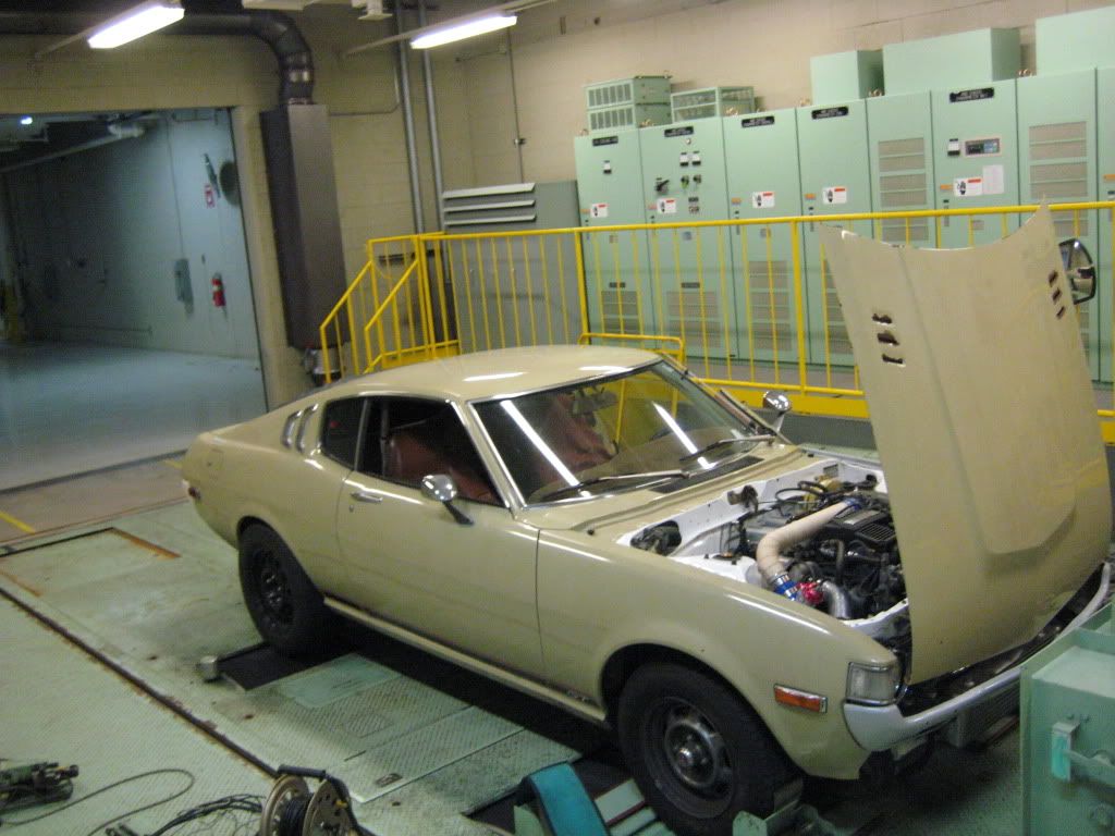

Need to use a dyno like this like I use :D
Good luck getting access to one!

^ water break dyno I see
but ya dyno jet's are just junk in stock forum, you can upgrade them with a loading drum but really there just not as good in the end any ways
