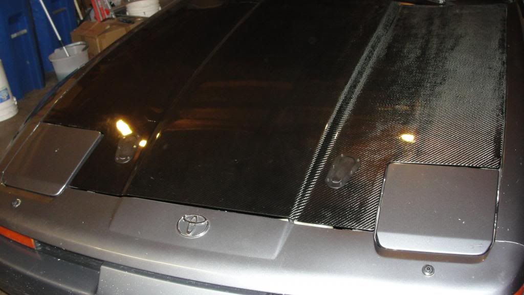

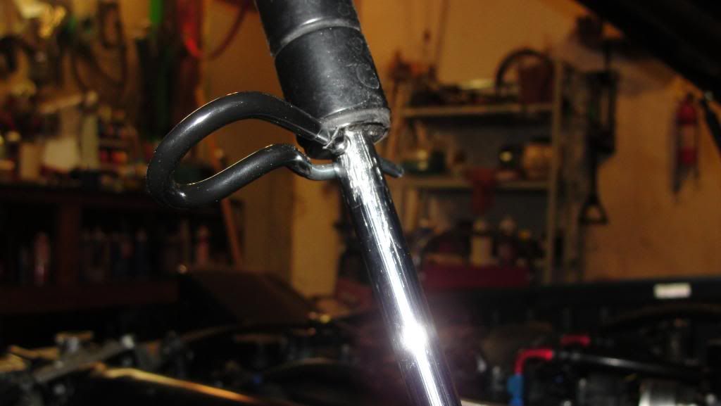

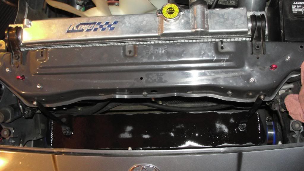

Blown stock struts, properly bolted to the body and hood- then you do this:
I'm using trailer hitch pin clips and have ditched the stock hood latch in favor of Aerocatch hood pins. Tthe old striker makes a great storage point for the clips, too!
Aerocatch pins look great and work as well as I could ask for
Missing latch/etc
