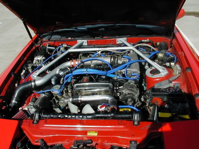

hrm what i did was sent the valve covers into a T that runs to the can and the other part of the can hooks up to the accordian pipe and thats it, works great
here is a pic
notice the silver looking hose goes to the valves and the other blue one goes to accordian... this is before i mounted the can ;p

ah i forgot to add that, i capped mine off. easiest to just use a a proper cap not jsut a plug.

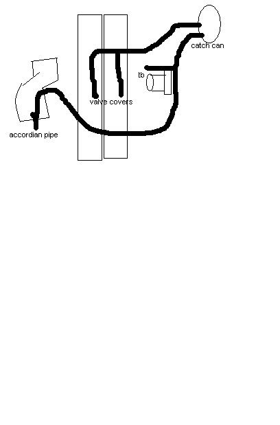

I would just T the vacuum between the accordian hose, and the TB - isn't that how the stock setup is? The covers are just on a T between the two? (venturi effect in action yay)

hmm, thats how i have it, i just dont see any oil collecting. i did notice today that the bottom of the can was oilly so maybe it did leak out. i'll give it a little more time and see what happens.

't'ing the hose that goes from the can to the accordian pipe, to go to the tb would seem logical.
so this would be the real way, if not someone correct me before everyone starts doing it!!:icon_conf

interesting, i just ordered my catch can.... so thank you all who contributed, and if any of you object to the drawing above, please speak up now, cause that makes sense to me!
