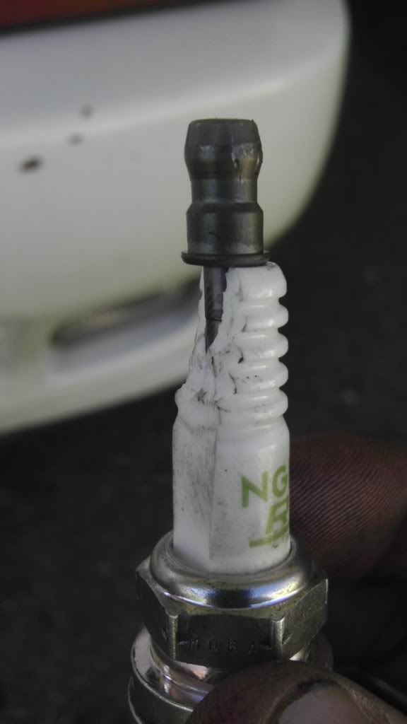

I pulled this out of the number one spark plug hole....
I torqed them all the same this is the only one that looked liked this
jonahs_supra
May 17, 2011
1,015
Lancaster, Ohio, United States
does your spark plug socket have a rubber grommet inside of it?
the grommet helps keep everything straight...if not installed and your not careful this will happen

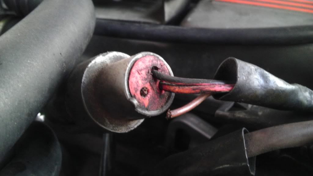

So i decided to go take a closer look at my o2 sensor cause you mentioned it and i really havn't been focussing on that to much

is the broken wire on the harness side or o2 sensor side?
also if you have code 41 and your sensor is completely shot then your car wont start
try throwing a noid light on a fuel injector and have a friend crank the car to see if it blinks
im thinking your tps has gone completely bad
also unplug your afm...try to start
if it starts then you yet again have stumbled upon a busted afm or bad wiring/connections

It's on the harness side of the plug.
Car starts most of the time. And when it doesn't just have to wait a couple minutes and it will. I'll check it all out though. Thanks for the tips greatly appreciated
