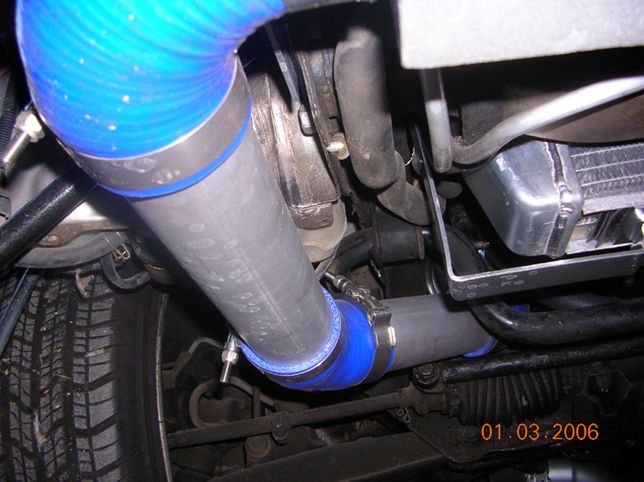

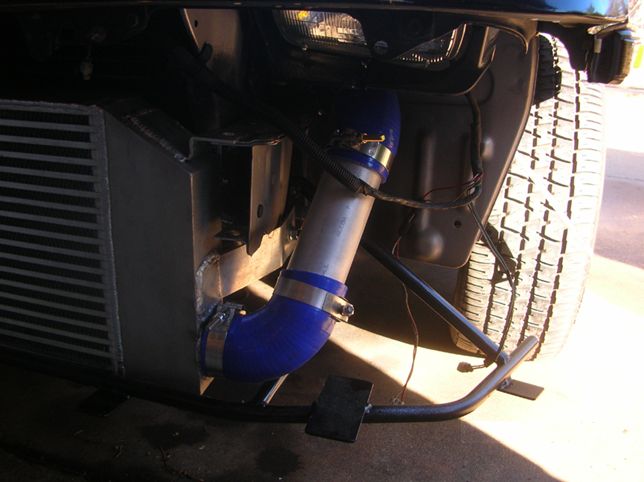

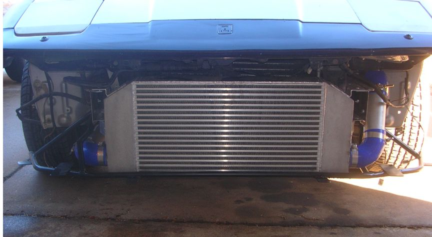

I get what you are asking, and no it's not a stupid question (I would not do what you are asking). None of my pipes for my FFI are welded together. See pics below. (But I did weld my FFI) This is also good because it allows them to "flex" with the engine movement.

Haha you so funny :dunno: Whats the support dealy? You mean for my IC, it's just 1/8 flat stock from the hardware store. And I propped the IC up where I wanted it to sit and then bent the brackets to fit, then welded them on. SO....if you want that you would have to ship your car to me.......Or are you talking about the Rad support? Again, the same applies, or I would have to rip mine out to copy it. I thought you were going a different route with your Rad? But seeing as we are way OT, we can continue this under my build thread :biglaugh:
