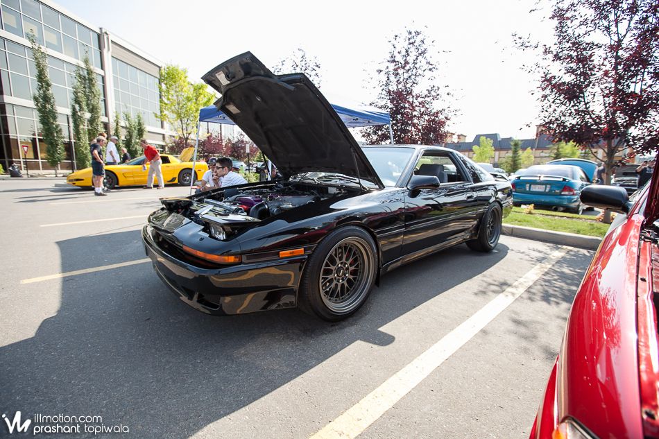

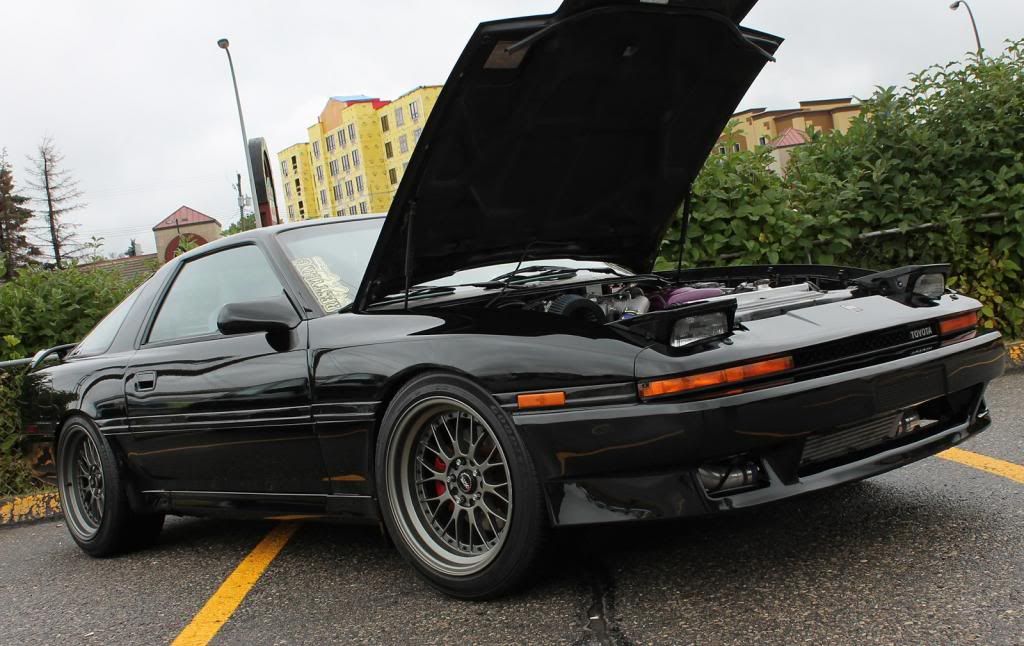

as i stude there all dumb founded i did not know what to say. it was like a perposal so of corse i sayed yes. i never found this car it found me. It was ment to be. and like i sayed it would never be treated like it was in the past. after the snow started melting i decided to pull her out of the snow bank and see what i had. after cleaning her up this is what she looked like.

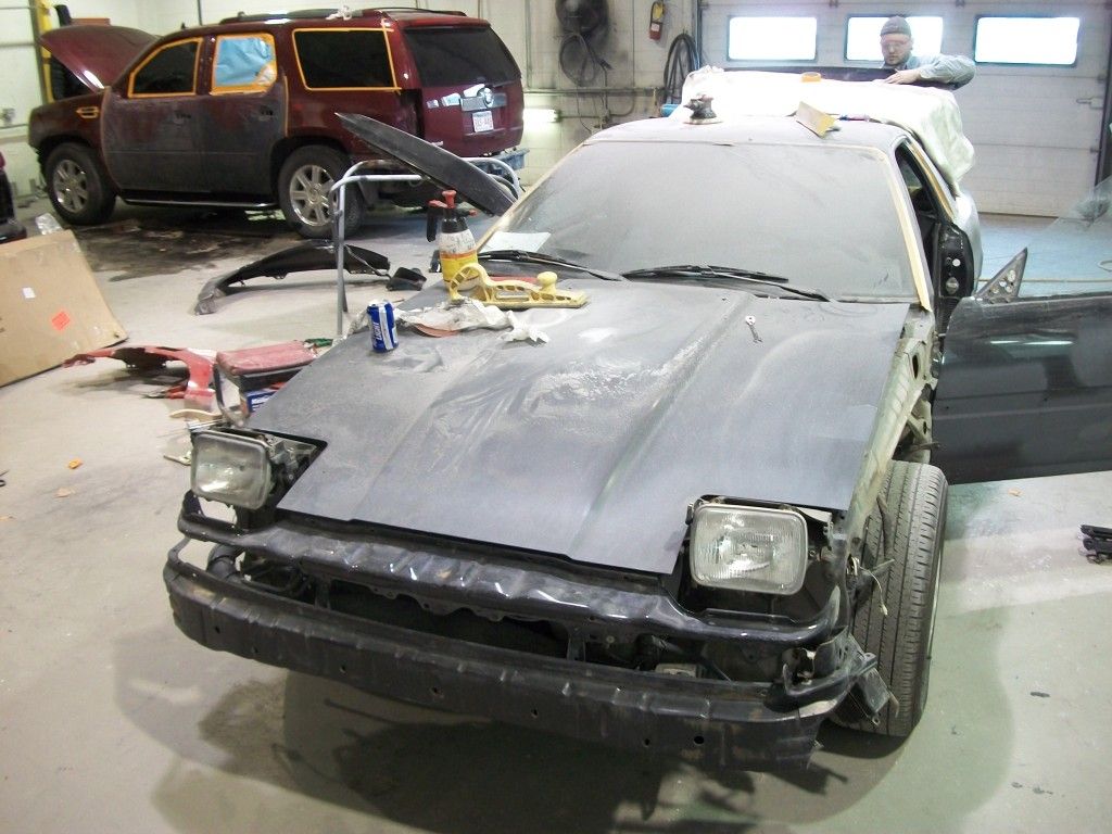

THE TARE DOWN,

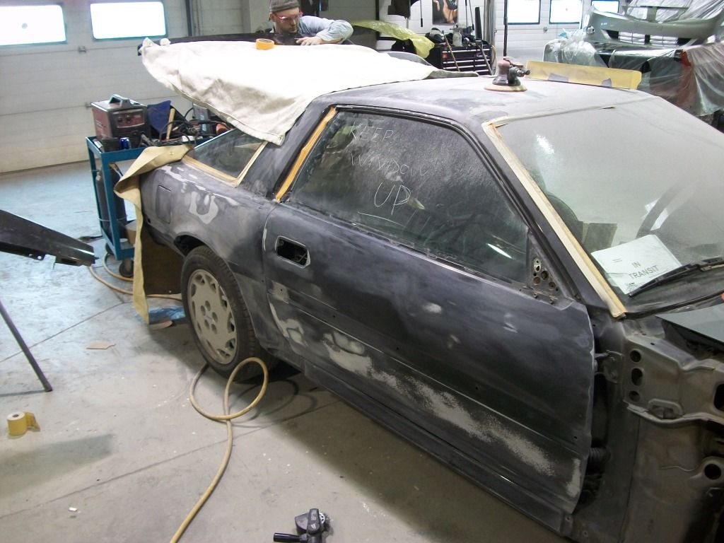

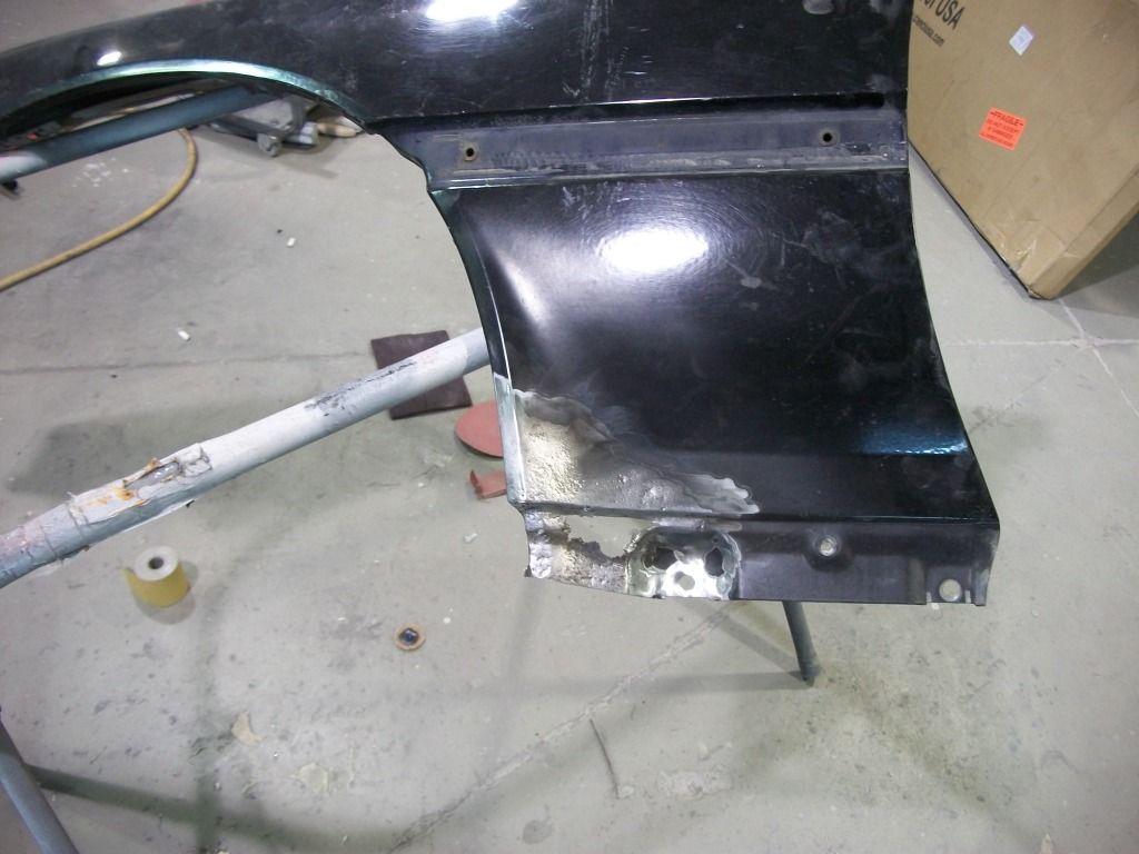

So after the agreement was made we when straight too body work as soon at the owners left for mexico for 5 months witch gave use some time. first thing was to asses the damage. passenger front fender damaged right rear quarter panel had bondo cracking and same with the roofe.

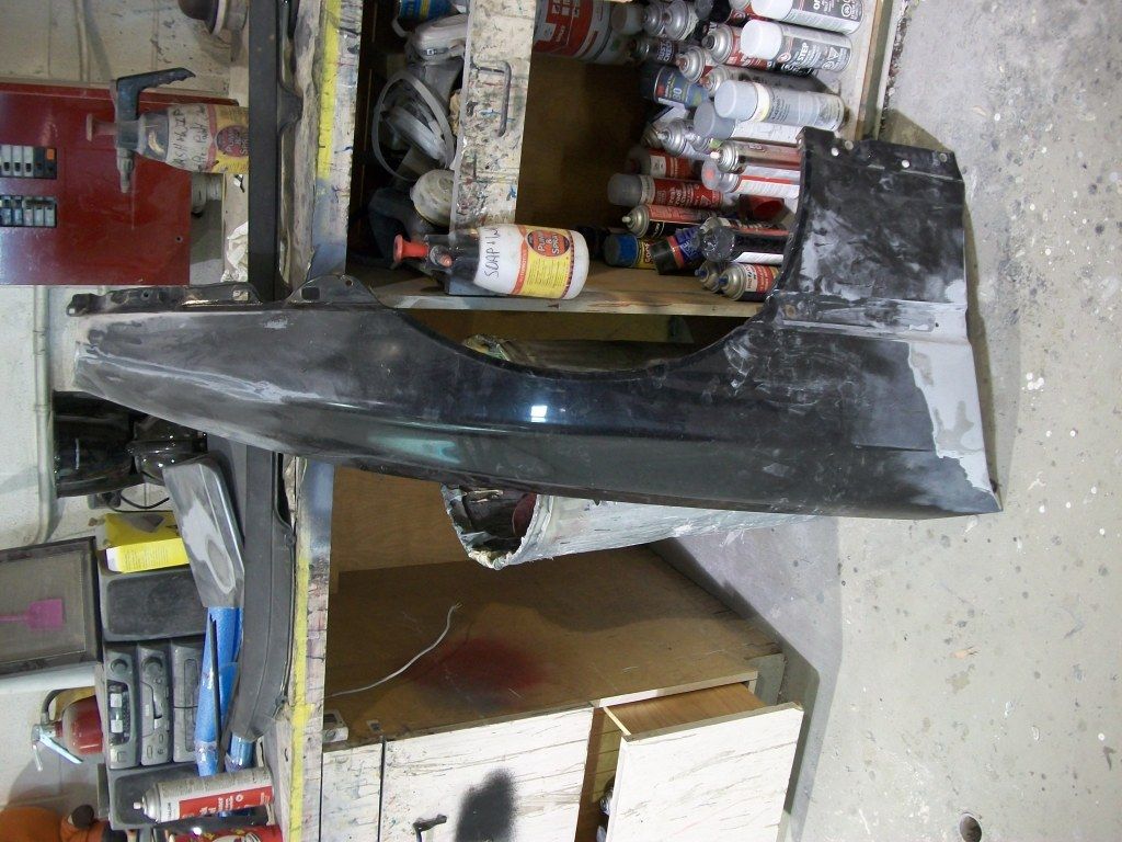

decided to keep everything original so we properly fixed the fenders, rotting had accured where the mud flap went so I chopped it off and made a new peace from garbage fenders at the shop. wial we where at it I deleted the rear wiper and motor and welded a penni in the hole and a loonie where the antenna went. :)
the section I chopped out

I love the 88 nose on your car. Sometimes I wish I had kept mine that way.. :)

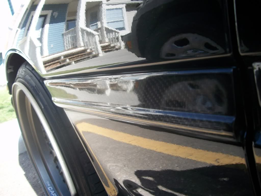

Well.. I still have mine in the garage hanging on the wall if I need.. lol. Your wheels rub at all with that set up? No wheel gap and not total slamnation... nice height.
drift zamurai
Sep 1, 2013
59
Airdrie Alberta
thanks, but ya they rub but that's because I just have lowering springs need to get me some coil overs I had to roll the inside edge on the fenders and quarters but if I was half inch higher I would not rub and wouldent have to roll the fenders. but once the interior overhall is done in the spring I will be doing a complete suspention over hall ;)

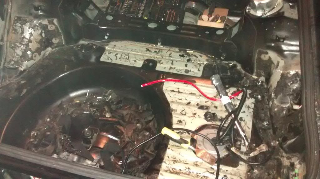

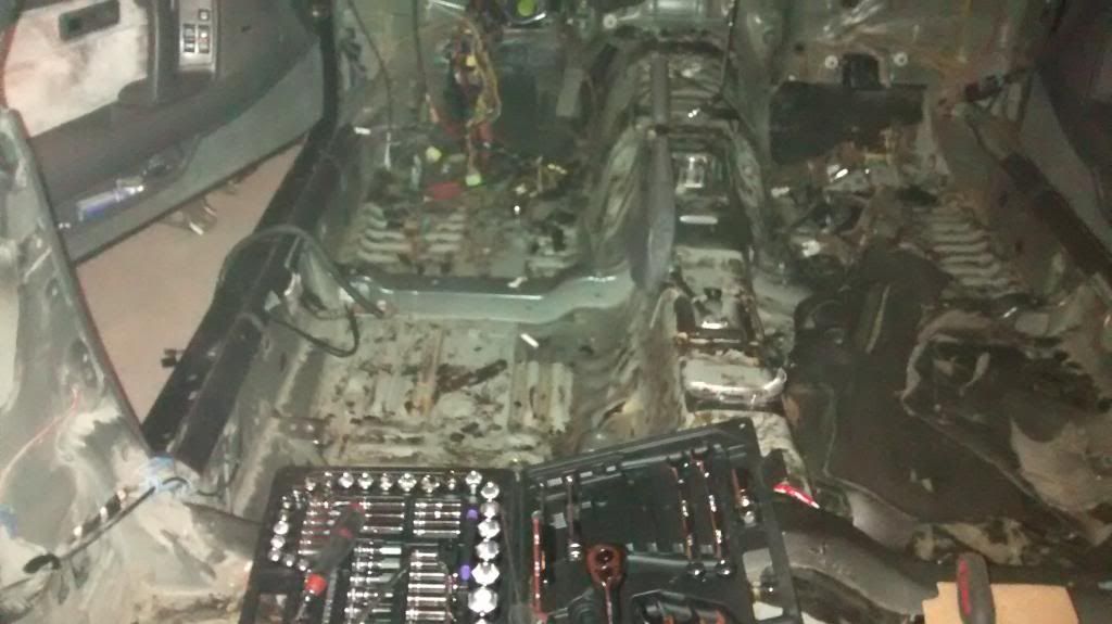

Now that the engine and body work is done, it is time for a little waight reduction. Stripped out the interior and sold it to grandavi. Won't be needing it no more :). Started by pulling the heat or core witch I won't be using eather, but am replacing for a Minny heator box with defrost and a single floor vent just for the chilly morning and evening drives. Lighter then vactory unit and i can get rid of all the pluming for vents and heator controler. This thing is so small so it will fit nicely behind the glove box. Has a low med high switch that fits where the Sig lighter was :). Also chissleing the sound reasoning out and removing all the insulation on the fire wall.

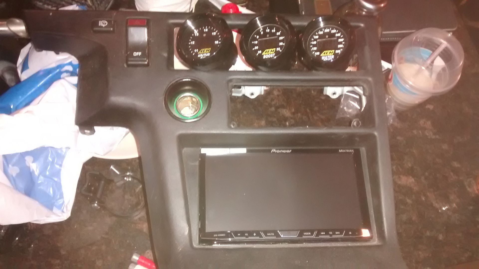

Wail I wait for everything to come in the mail I grabed a few things for the interior
Also playing with gauge layouts
