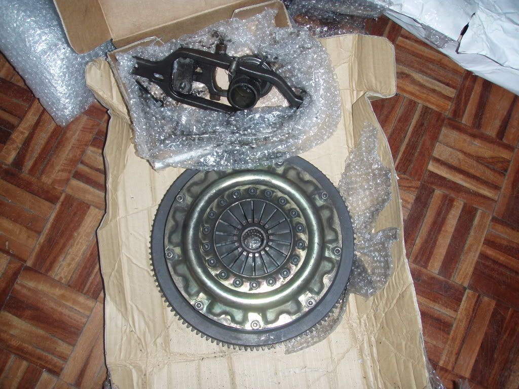

As old cars do, the auto transmission decided to forget to shift gears on me. So I had to sometimes take of from 3rd, worst feeling in a turbo car. I decided at that point I’d look for a 1jz and prep it to go into the car. Couple of weeks later I found my 1jzgte with an attached r154 and all the bits with it. Stupid me decided I’d throw the r154 behind my 7m and continue with my trek of “teh Poo”. I bought an Os Giken twin plate and had myself a custom 1pce tail shaft made, it weighs 2/3 the weight of the stocker.

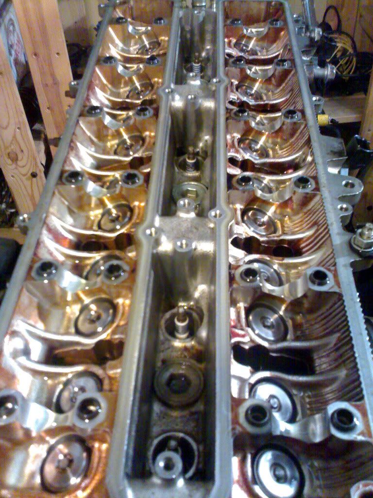

Out came the motor. Off came the auto. Turbos, intake manifold, and anything attached to the block and head. I checked all the bearings for abnormal wear or damage and replace all the rod bolts with ARP units. Turned the block over and replaced all the head bolts with ARP units also. This part is a lot harder than it sounds. The head bolt (10mm, 6 point star?) rounded off and I had to drill the bolt out buy slowly upsizing the size of the drill bit till the head popped. Once that happened I was able to screw the bolt out with my fingers.
Off came the stock valve springs and the valve stem seals, why go through all this work just to burn some more oil. In went new seals and my shiny new springs and retainers, 74 lb springs and Ti retainers.
