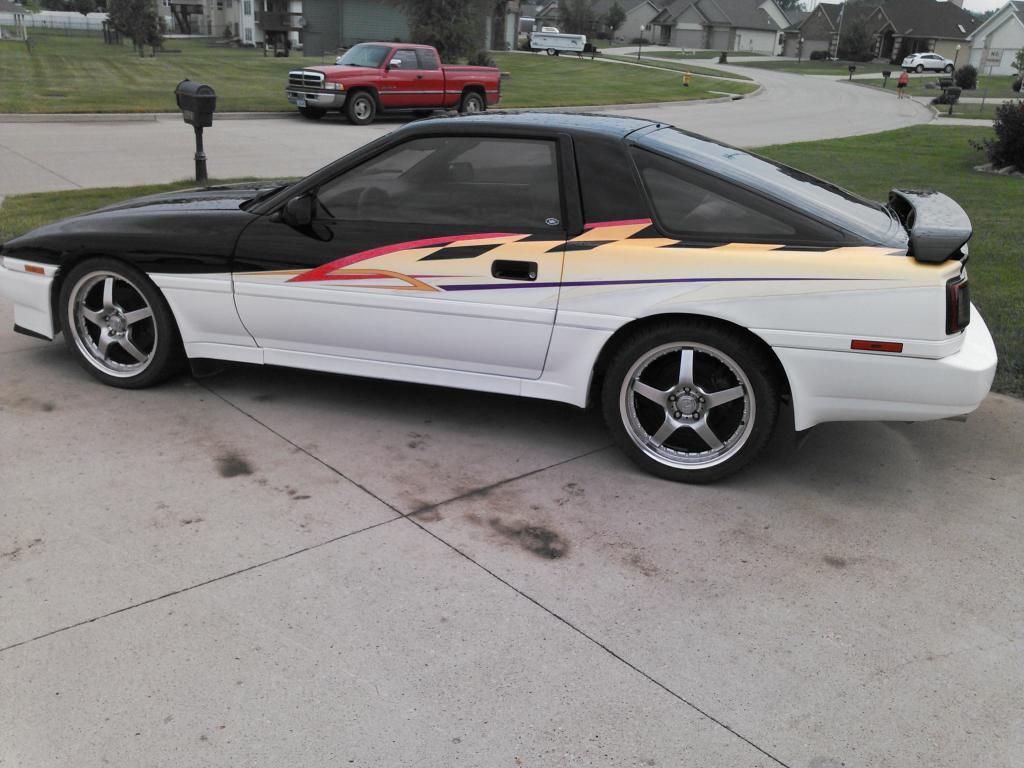

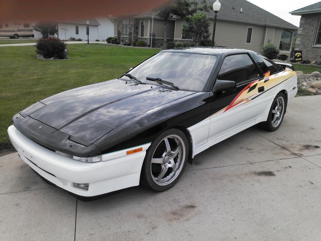

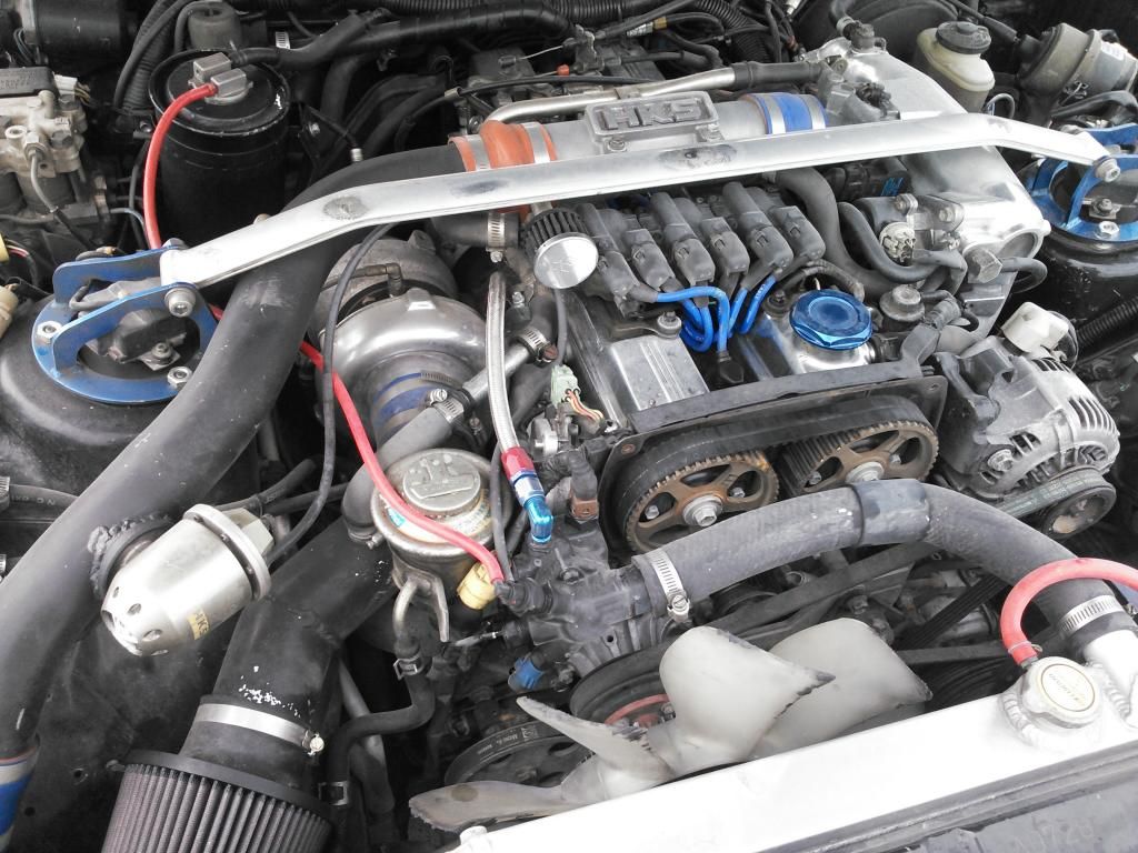

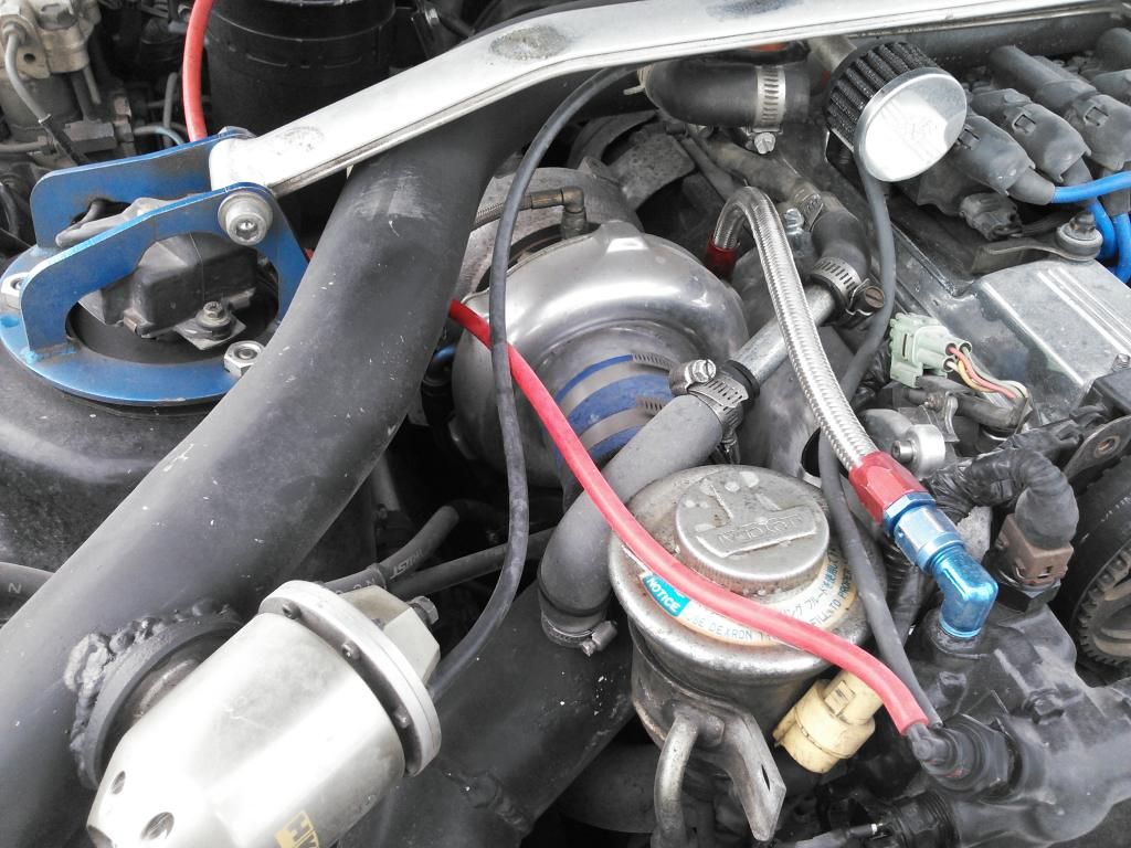

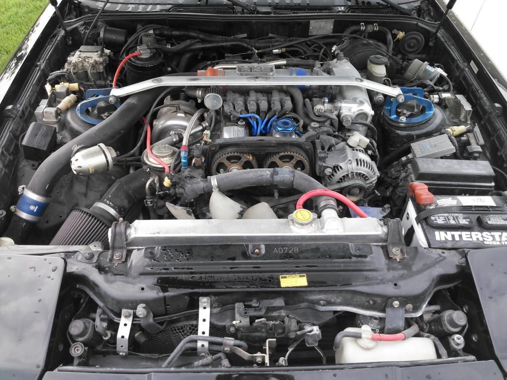

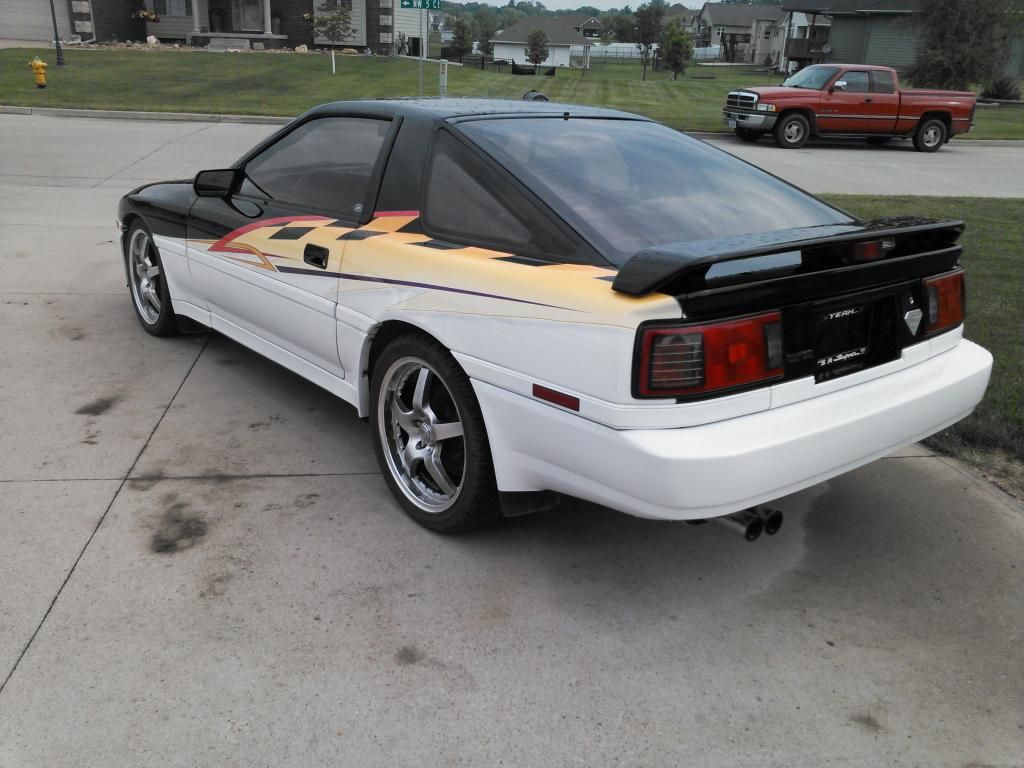

Here are a few I took this morning. I washed it up last night, but it was too dark to take pictures, then it had to rain this morning. Also excuse the dirty engine bay. I need to degrease it next time, they lived off a gravel road about a mile, so it was a little dusty.
Also if anyone has any ideas on what turbo setup is on it please share. I know it used to have a 60-1 upgrade on it, but I have heard its a sp67 bolt on. I just need to dig through my file and see I suppose.

Definitely have seen that car on this forum before. Can't recall who owned it though, but it seems like you got your self a good deal there. Bunch of nice parts and a big ol turbo :D
