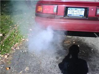

Well heres the story.
I start my car up (NA-T 7mGE wit hTurbo electronics), and i get a pretty bad blue/purple smoke. (fuel)
As im driving it and look behind me, there ALOT of blue smoke. After i drive it for a second or two, and i slow down or stop, i get massive amounts of white/grey smoke. And it smells like exhaust. Not really sweet like antifreeze, but jsut like *exhaust*. You know when you start your vehicle up in the cold and get that regular exhaust smoke? Its JUST like that, just ALOT...
The vehicle drives fine, but the smoke is terrible so i stopped driving it. I pulled the plugs today and ALL looked great except # 6 which the threads of the plug were soaked in oil, and the bottom of the plug was very dark colored and looked to have a coating of oil....
Next, i did a compression test, and the number came out something along these lines:
155
155
155
155
155
160
Next: My turbo is NOT coolant driven and only run on oil.
Recent things ive done to the supra before i started having problems: Intercooler upgrade, and an oil change. I blew off a coupler the other day as well.
Question: Any ideas on whats wrong with the car and what could be causing these problems?

100% positive. You dont understand how bad it is. I am going to post up a picture in a second, but its about 55-60 degrees out right now, and its to the point that after letting the car run for 30 seconds to a minute, i can not see my house.

This is after about 30 seconds of running, it gets much worse as time goes on.

Man... hows the head gasket.

I did a compression test last night and the head gasket seems to be in perfect condition. It DOESNT smell like antifreeze either. It smells like exhaust. Thats the ONLY way to describe it/ No oil smell, no fuel smell, no coolant smell.
155 across the board.
JonoTurbo
Going for broke
670
CT
If the exhaust smelled sweet, i'd say you had a BHG for sure, and I still think it's a possibility. Compression tests don't usually tell you if you have one. You would be losing alot of something with that kind of smoke, if you're losing coolant that's probably your answer.
Pick up a coolant tester from napa to see if you have exhaust in your coolant, that test always worked better for me.

Heres what happened:
The turbo seals we SHOT. It was from an original turbo, and wasnt known to be in the best condition. I kept upping the boost, driving it HARD everyday at 12 psi.
Even though my turbo wasnt coolant driven, and i was still getting white smoke, it made me wonder. I took the downpipe/elbow off to inspect the back of the turbo. As i loosened the bolts, what seemed to be a solid liter of vanilla/chocolate milkshake poured all over the garage floor. "o shit"
I thought this could lead to either bad turbo seals, and oil leaking past, or a BHG. My next step was to see if the milky colored liquid was coming from the motor. I pulled the turbo off the manifold and the inside of the manifold was completly clean 100%.
So that means: My turbo is blown.
Any questions?
