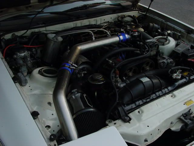

i used about 9 ft total length for the stock routing of the pipes, i think i ordered the following.
3) 45 ells
3) 90 ells
1) 180 U-bend

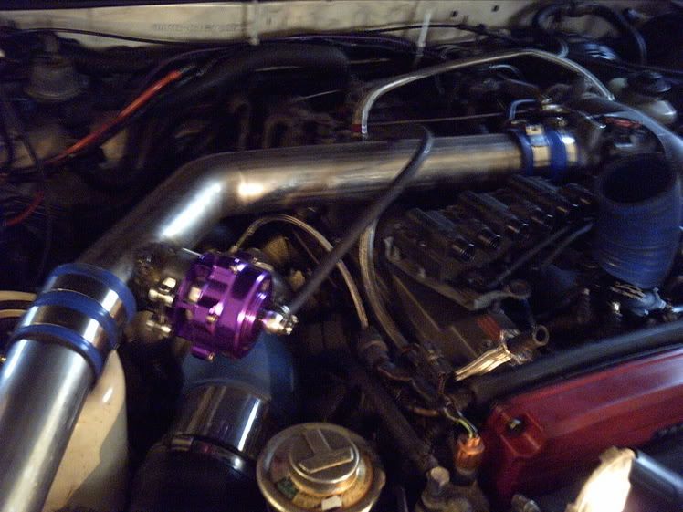

If you like the look of my style IC pipes, I could do a write up for them.
Not to mention a possible kit priced to sell cheap from MDC.

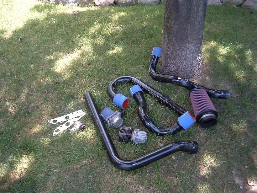

This is all the piping I used:
Started with five 2.5" mandrel u-bends, I have lots of piping left over.
(piping is steel, its painted black and has steel reducers welded to fit endtanks, cheaper than silicone reducers.)

and where is your BOV blackout_89t?
