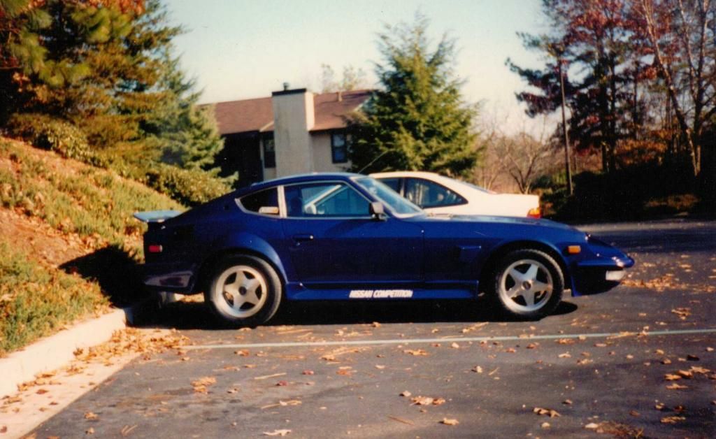

I have owned this car since 1989-90 I restored it to the best of my ability back then with an L28 and 5 speed and 16 inch Rikens. When I finished restoring it I was still in school and I told my Girlfriend she could drive it if she paid for full coverage insurance. Sounds ill advised, but I trust her more than myself. I had to marry her to get the car back, thru life changes and location changes we never considered selling the car but due to electrical problems the car sat for almost 10 years. I never really wanted to put it back on the road until I could do it properly. PROPERLY = fuel injection and a turbo. Clifton had come across a 7MGTE and it was the perfect swap, it ran great it passed emissions and the AC worked great. He said the initial swap took him 6 weeks, I had a bit more I wanted to modify and I am definitely slower than him, it took me 6 months to get mine running. He was always of the opinion "minimize the down time, get it back on the road as soon as possible". This philosophy has served him well, but as long as I was going to do it RIGHT and since my car wasn't running anyways I could keep making it faster before it ever ran. I would have a hard time talking my wife into taking an already running car apart just to make it faster. I never counted on breaking it so many times and being able to make it faster then. Clifton had found a complete drivetrain for me and I got it from him late in 2004, the race was on to try to get it on the road before MSA West Coast Nationals 2005. Take a look at all the mods I did and I think you will agree that I did get quite a bit done after work and weekends. I will try to document what I have done since 2004, as always the car is still a work in progress, but many things are as good as they are going to get.

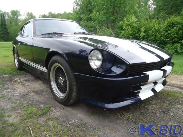

Here, what it looked like in 2005 when I rolled it out of the garage, just before the 2005 West Coast Nationals.
