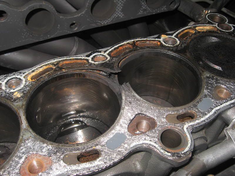

suprajztwenty;1960711 said:
this is what watts performance gave me when he decked my block for me.
Same guy we use. He does the machining for Dynosaur, PHR, MVP, AWDTuning, and many others. Use with confidence :)
