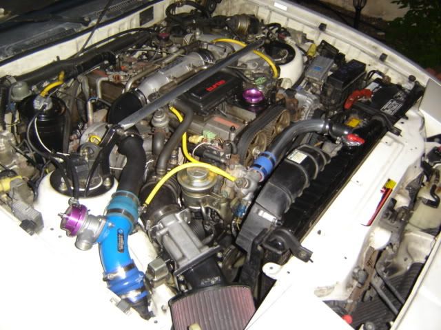

maybe this will help...not sure if all BOVs huk up the same tho but ya...
OLD pic btw...
