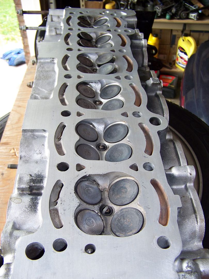

Yes!! Got it with some PB blaster and a 19mm 1/2 driv socket. I should have the head off tomorrow. Kenny, you should post the pics up that I sent you of the engine bay.
boost_victim
here
myspace.com
head is off new pictures in orig. link.
i have a dilemma, to go mhg or not to?
non metal head gasket:
Felpro head gasket arp studs.
metal head gasket:
cometic and arp studs.
need some help which would be a better route?

I went Felpro w/ ARP's for a year and a half, around 12 psi on stock CT, no problems.
I guess it depends on what kind of power you're going to demand from the motor.
boost_victim
here
myspace.com
thats about what i want is some thing around 10-12 psi. nothing crazy, the head i getting checked tommorow for warpage and cracks. i am probly going to go with the felpro. i figure that after its all said and done its going to cost about $350 in parts + some odds and ends here and there. a.k.a oil, coolant, etc.
