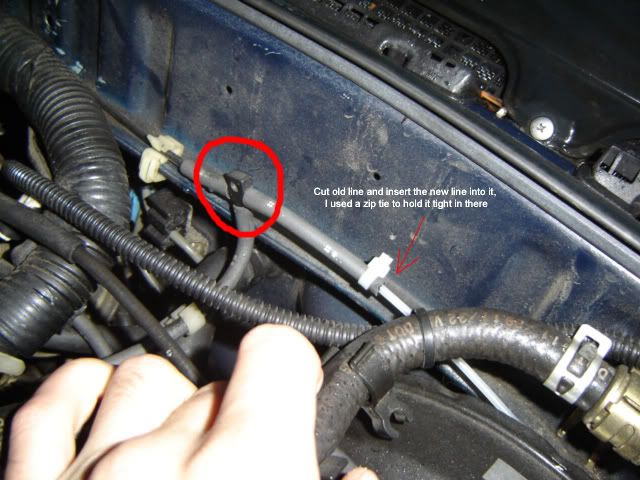

whats up, new to the supra world so need a little advise on which vacuum line to tap into for the boost gauge.

use the vac line coming out the backside of the intake manifold.

I used the T at the firewall, where the stock boost gauge vacumn line comes from.
