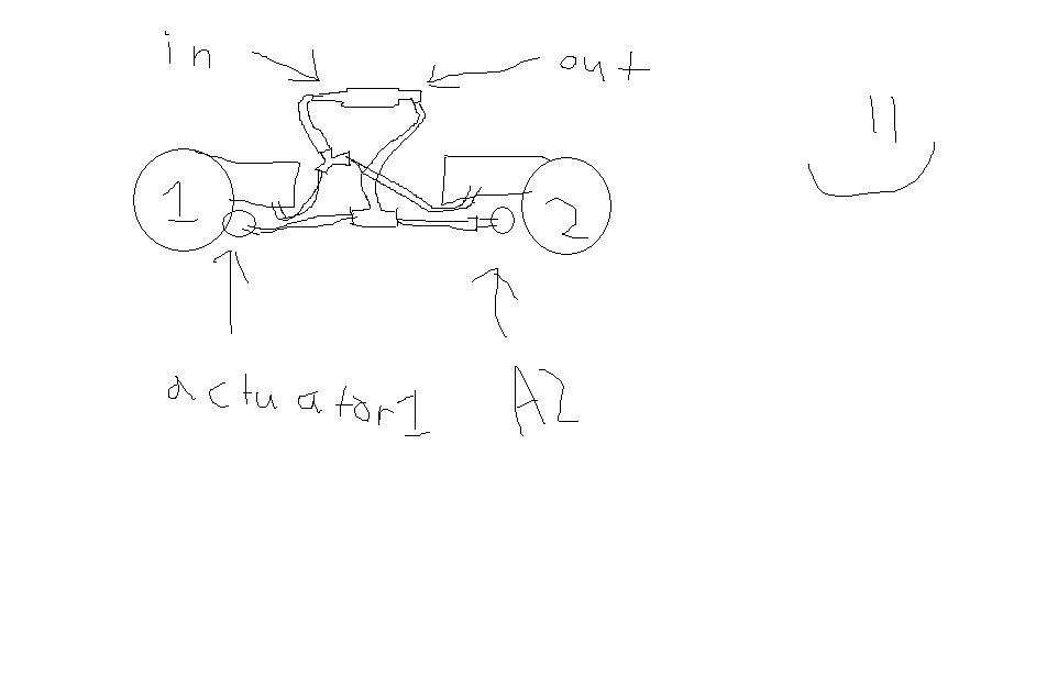

I am looking to setup my Profec B. I am wondering if there is an easy way to get at the actuator vacuum lines, and hook it all up. I have not hooked up a boost controller on more than one turbo, but I dont think It will be too complicated. Any advice is more than welcome.

Tee the two compressor sources together, then to your boost controller.
Tee the two wastegates together, then to your boost controller.
That's all there is to it.
It's just the same as one turbo except you have to tee the two turbos together into one hose before it goes to the boost controller.

Behold my beautiful MSpaint art for visual aid.

awesome paint Joe... now the real question is how the !f..ck! you get to the actuator hose of the rear turbo w/out removing a lot of shit... is there a trick to this you know of :(

very very long needle nose pliers, and a lot of patience.
You can do it with your hands. What I did was remove that rear U air hose that goes behind the head. The one that connects to the ISC. After I took that hose out and move your harness out of the way a bit, I was actually able to reach behind the head and get my hands on the rear wastegate and rear compressor source without any pliar. Try that. Pliars can help too but I didn't have the right ones.
I didn't have to remove the pipes to do this.

Should the lines going to the boost controller be the same or damn near the same length? Or better yet, will it make a difference if they are not the same length.
On a different note I did get it hooked up, it only took like 3 hours, lol. I am retarded. I had a few minor "issues".
Thanks alot guys.
