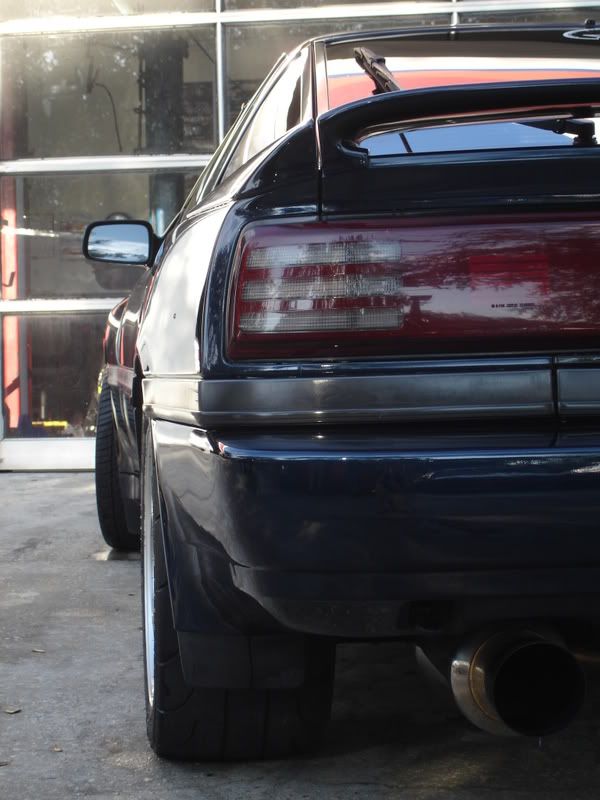

Not the best picture of how much it sticks out, but it does.
