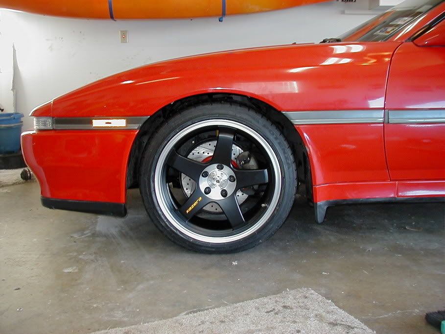

Just posted this the other day for someone. Here is my car with Bilstein's set to the middle spring perch front and rear. Car is on 18 inch wheels. Hope this helps.

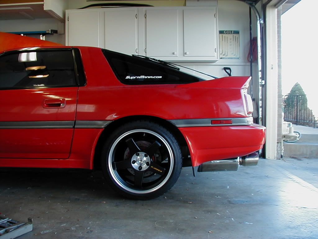

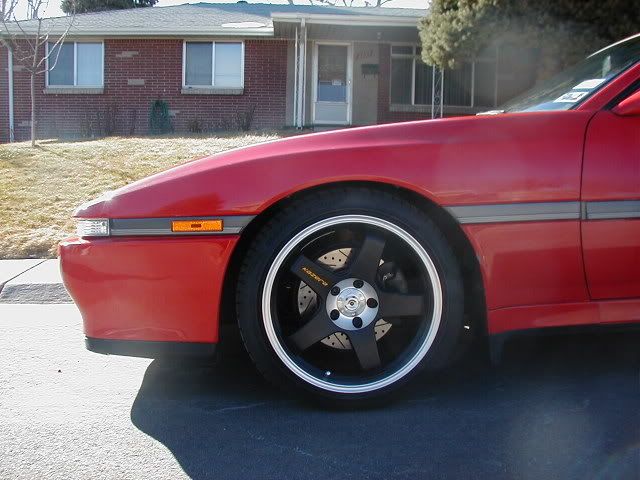

with my eibachs i set the rear to the lowest setting and the front to the highest setting (iirc) i'll doublecheck its been a couple of years since i put them on heh
this is before i started the engine and when i just put the car on the ground
after
all pics of when i had my 7m in the car not the 2jz
