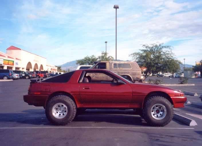

I believe those are the biggest tires. 20'' wheels will fit, but you will most likely have rubbing issues.
