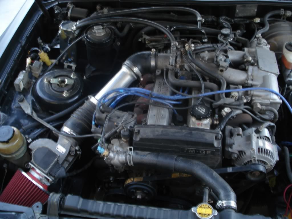

Ok I just got back from the doctors office and hooked the catch can back up.
I found out where the hissing noise came from which was the two vacuum lines that go into the pcv valve were disconnected. However, after reconnecting them, and reconnecting the catch can, I still have terrible performance. My RPM's are soaring above 2000 at idle which is kinda scary and I dont want to trust this thing.
I have been looking at various threads on catch can installs but they are all for turbo cars with turbo inlet pipes. When I purchased my car the accordian hose had a vacuum nipple on it and when I replaced the accordian hose for a hard pipe I T'd the vacuum line into another source of vacuum. By my logic the catch can should be installed properly as well as the lines based on the turbo ones where there is a pcv source of vacuum on the turbo inlet pipe, but there is not one on the N/A accordian hose.
I tried to take a picture but it failed (cameraphone) heres a splendid drawing for you Jdub.

Rennat
5psi...? haha
Dec 6, 2005
2,844
Tracy, CA
thats how it 'should' be.... at least on the n/a.

jdub
SM Expert
Feb 10, 2006
10,730
Valley of the Sun
Thanks for the pic...just making sure the routing was correct. It is ;)
(The PCV seems to be one of the most screwed up when a catch can gets involved)
I think you figured out the problem...pirate air via the can itself.
