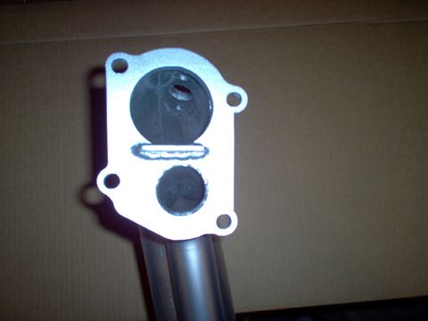

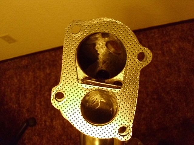

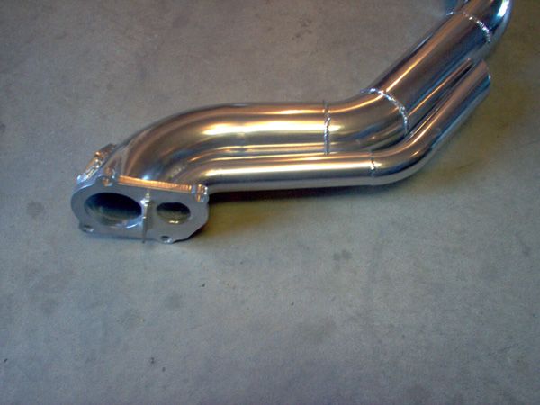

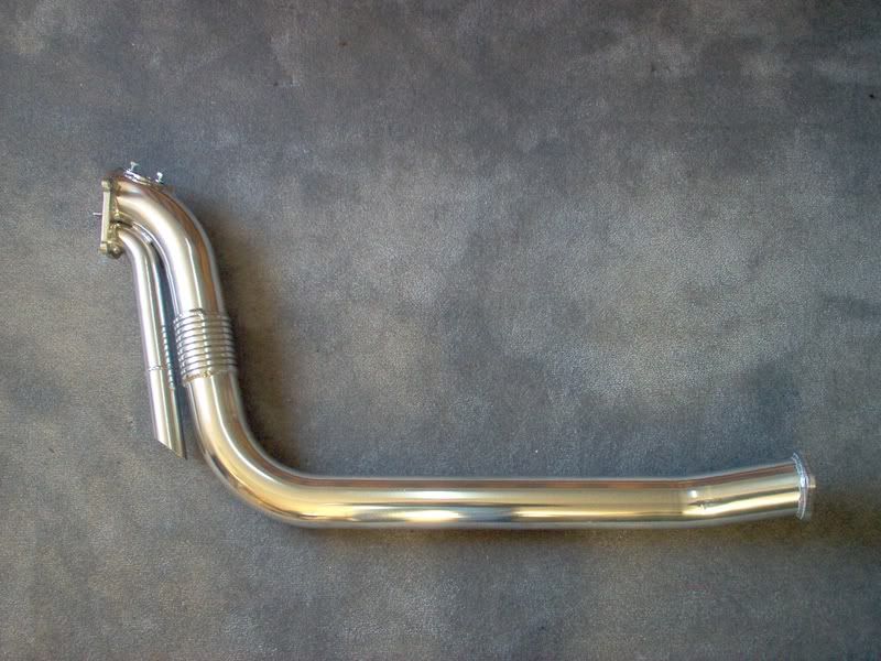

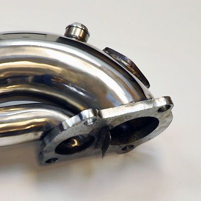

So, what option would you guys choose?:
- Cheap Ebay DDP: http://www.ebay.com/itm/Toyota-Supr...Parts_Accessories&hash=item2a1bbb5572&vxp=mtr
or costly $400+
- BIC Performance DDP: http://www.bicperformance.com/images/ddp_new.jpg
Based on my knowledge from an MAE Fluid Mechanics course I've taken last Fall 2013, I'd say the Cheap Ebay option is not the best choice because there isn't a "Separator" piece btwn the exhaust path and wastegate path that would aid against exhaust flow disturbances (back pressure/turbulence). Not including the wastegate valve/flap hitting against the dump tube of the downpipe.
But then again, I'm not sure; maybe it would be alright...?
