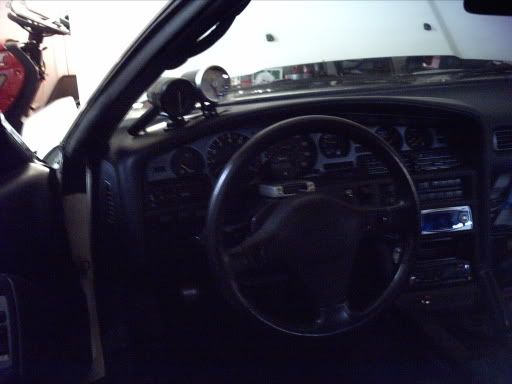

I have a Blitz Dual and its pretty nice. It does the basic turbo timer stuff and ebrake safety, plus has nice extras like boost disply, peak boost memory ( very useful ) peak boost warning, lap timer, and different idle time settings. You can get cheaper TTs, but @ $120 shipped I would buy it again.
Here is a photo just for fun, the Blitz display is a little fuzzy but you can see how small it is and easy to mount. The main control unit is well out of the way behind the dash.
