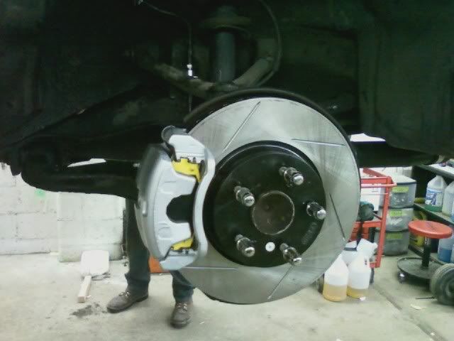

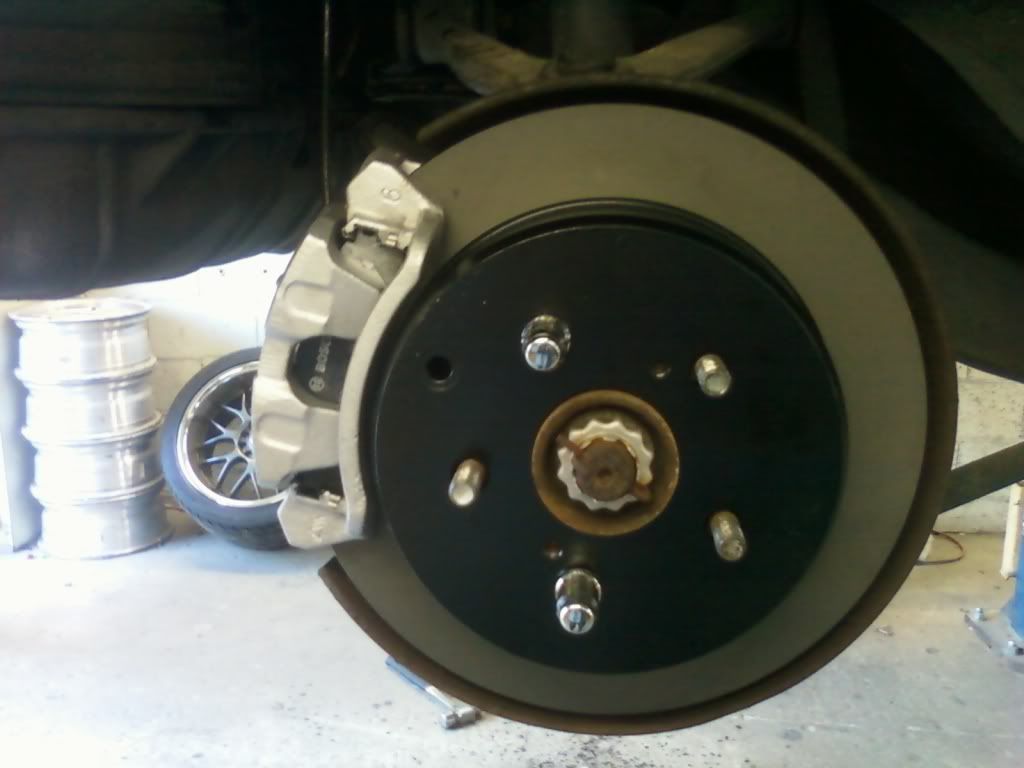

fronts have yellow stuff pads with centric slotted rotors and the rears have centric premiums with bosh pads to save money have had great results so far
check this site out (i haven't used them myself but have heard good things from another member here)
http://brakeperformance.com/index.php
