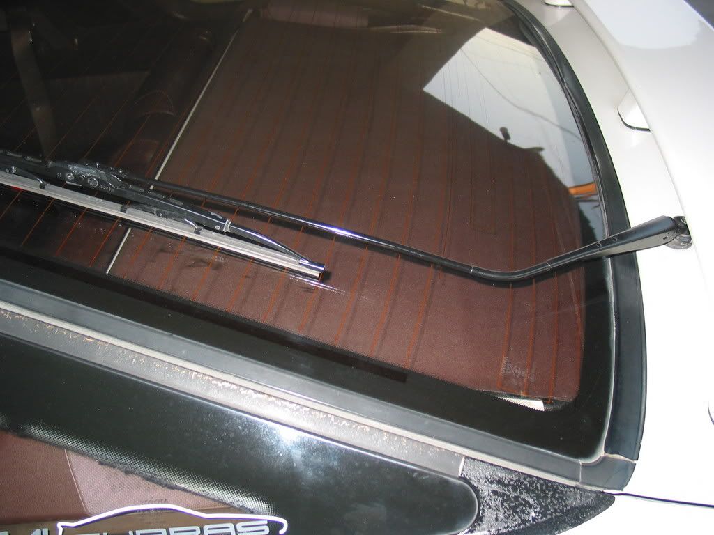

Hey everyone,
Just been thinking lately of a way to make the black plastics / rubber within our cars with that rich and lively colour.
I.e. the Door Seals, the part where the Wipers are whcih is big piece of plastic, and any other part that can be detailed.
What is the best product to use, I have Meguirs Natural Shine (Vinyl and Rubber protectant) which for Rubber is doing its job, but the part where the Wipers are depending upon which angle you look either looks rich black or same fadey dark grey.
What do you guys use for your Supras?
