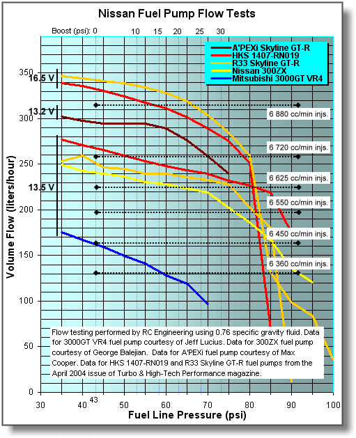

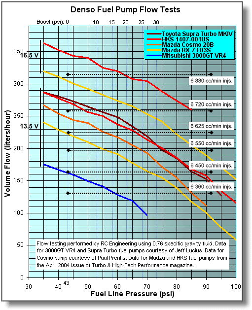

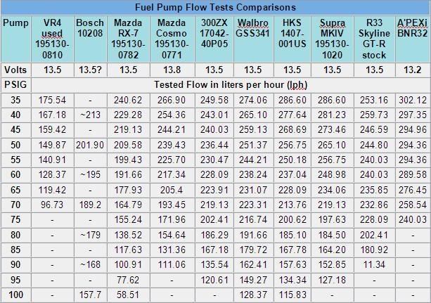

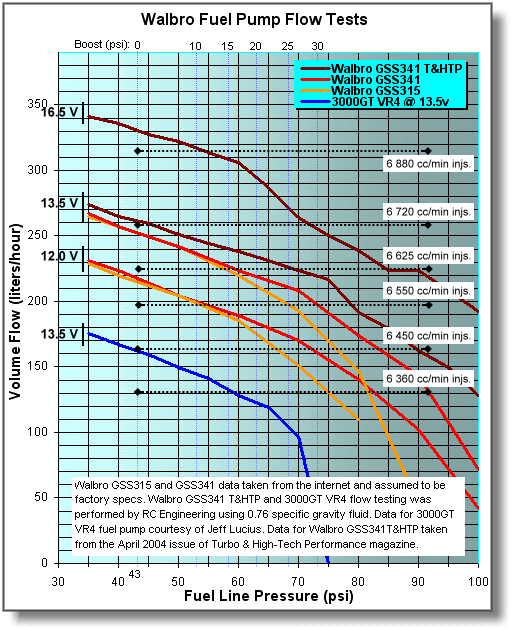

Here's some sheets with several tests and this website has a lot of info:
http://www.stealth316.com/2-fuelpumpguide.htm
To clarify for future readers, this pump was the denso OEM supra 255 LPH pump # 195130-1020
