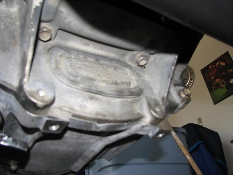

wait, i just bought one of what I thought these were from tlo..
just to be clear we are talking about a 6in or so opening where you can see into the bellhousing looking down from the motor side correct? I mean its a big ass gap and i figured the clutch might slip or like tlo said rocks and etc getting in there and screwing stuff up.

on the 7M it was an inspection cover, its sort of built into the JZ oil pan and the bellhousing bolts to the pan. its a piece you should have gotten apart of your engine but usually don't. its the only way you can see into the clutch area when the bellhousing is connected minus the inspection covers on the side.
this is a pic (of what i sent)
