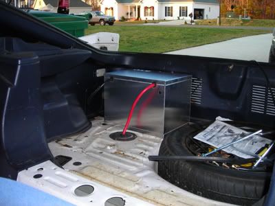

do you have a battery box and all that stuff yet? If you can wait till later I will send you some photos of how I mounted it by drilling two holes to allow me to attach the nuts and lock washers on the underside without dropping the tank

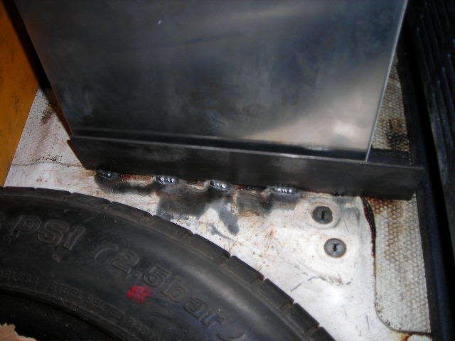

i cut out my spare tire wheel and welded in sheet then sunk the box down as low as i chould looks nice and keep's the weight low as possible

Here you go Adam. It is kind of hard to see but I used the hole closest to the back of the car from the tank access which allowed me to slide the nut and lock washer under and thread the post down (I would also suggest using another lock washer and nut on the other side). Then I drilled a hole on the other side being careful as to not drill a hole in the tank cause there was less than inch of room. That also allows you to get a lock nut and washer on the underside but it is a real PITA especially if you are doing it by yourself as you have to have one hand between the gas tank and car and the other in the trunk holding the post. If you have 2 people it will be much easier. You should also to the fuel pump rewire while you are at it.
