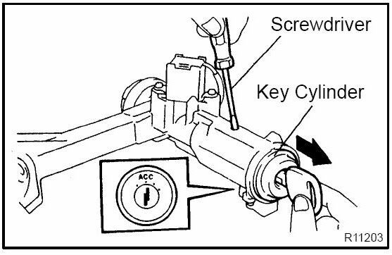

how does your key look? could this be wear to the key/tumbler/end switch plate....
I can't remember right now what the part behind the ignition lock looks like, but sounds like a similar problem I had on my nissan, where the key tip protrudes through lock and the tip engages another switch which was worn into the wrong shape...
^check this part for wear/tear and to see the slot shape, if it changed enough it may not go back to the "off: position

Thats the iginition switch. I took it out and even apart and it had no wear on it or it in. Contact points on the inside looked new, cleaned them anyway since it was apart.
