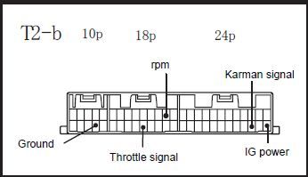

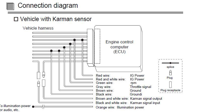

So my I’m going to install my neo today and just need a little help.
i already have the pin layout. I’m just a little confused on were some wires go.
this is for an 88 ecu and would like to know were to run these wires from the neo to, on our harness.
http://www.supraforums.com/forum/showthread.php?356573-How-to-wire-MAFT-with-SAFC
1.rpm signal? do i get this from the the cam position sensor and if so which one? NE or G2?
2.throttle signal? obviously tps but again there is multiple
3. Karmen signal output and input?
thanks for the help
