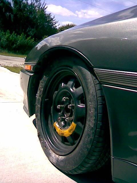

see here's the suspension. ITS WAY TOO LOW

The Reaper said:
well the dude i bought the car from said it was expensive....
Sorry to hear about your suspension dilema, but I couldn't help but notice the wheel lock on those super nice rims you got there.:biglaugh: You don't want anyone stealing those sweat wheels do you?:naughty:
