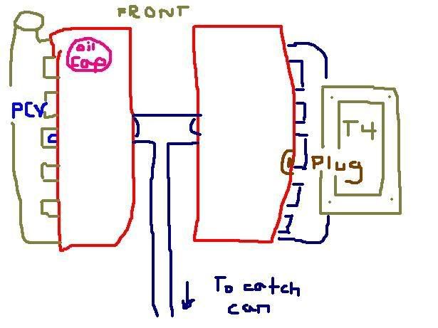

Anybody try this PCV routing
garagefujimoto
Local Tire Destroyer
May 27, 2005
997
Calgary, Alberta, Canada
Seen this the other day on a tuned single turbo 1JZ
The PCV hose on the turbo side valve cover would have been about 3/4 inch from the turbine side, and would have melted.
So it was plugged and the oil out was taken from elsewhere.
Seems ok to me...opinions?
It still has vaccum through the covers, although the exhaust one maybe doesn't vent quite as good anymore.

i would want an -10 coming of that tee.probably hard to get the coil pack cover back on though

No sorry no real pic.
The hose is -10 size high temp blue silicone/rubber
The cover still fits
I just started to do it on mine
I will make a real pic when done unless someone posts that it will explode the motor

make sure to run the other side of the catch can to before the turbo though.. so there is some slight vacuum on it

Yeah...from looking at the valve cover, anything above the "slosh plate" that is inside the cover seems to be the oil mist area.
This guy bags the car hard with a 70+mm turbo and there was no oil from the exhaust and the catch can was not full at all
I'd be more concerned with a high mileage engine, but this one only has 3000 km, so I think blowby should be under control
