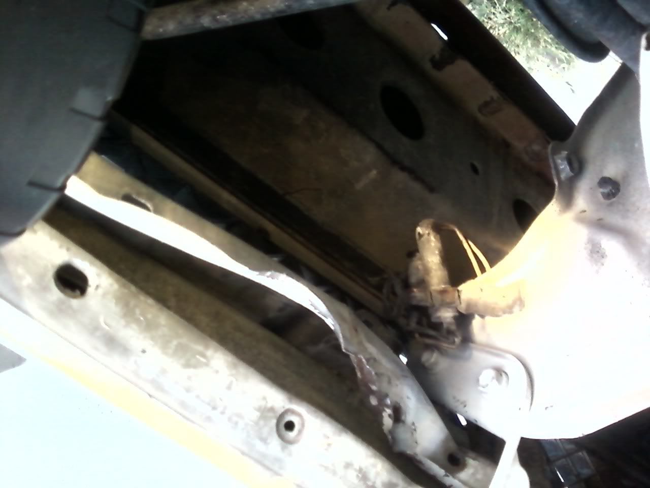

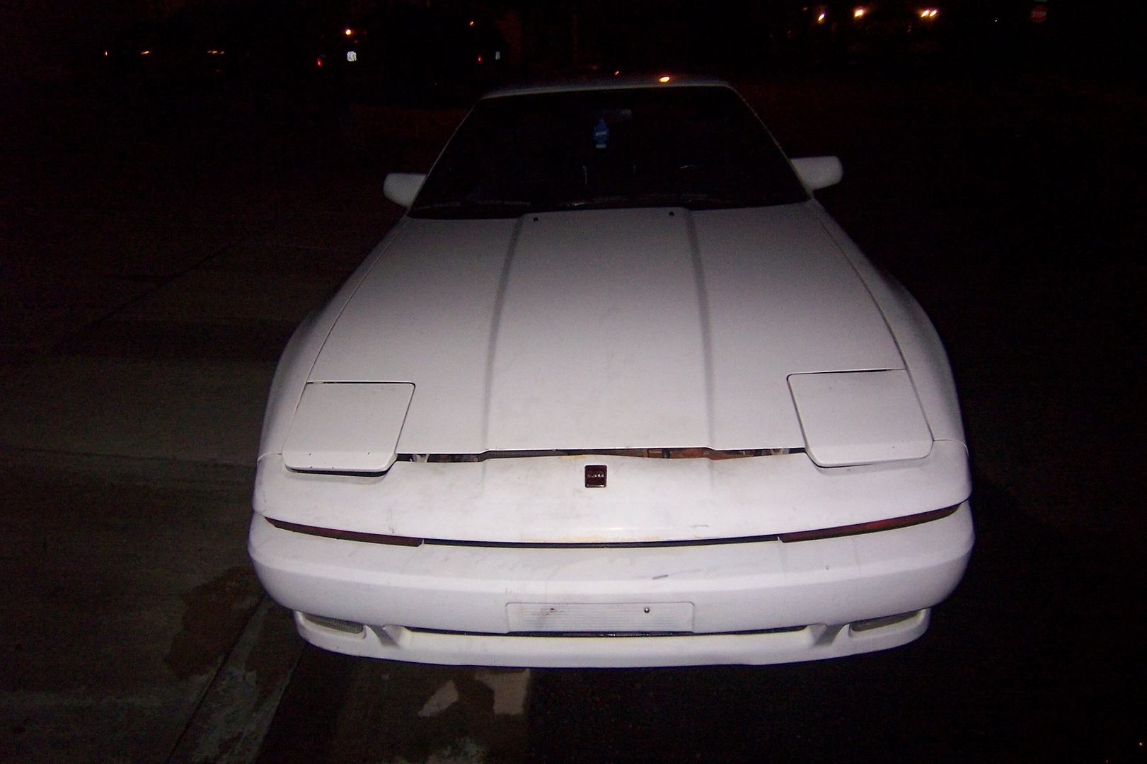

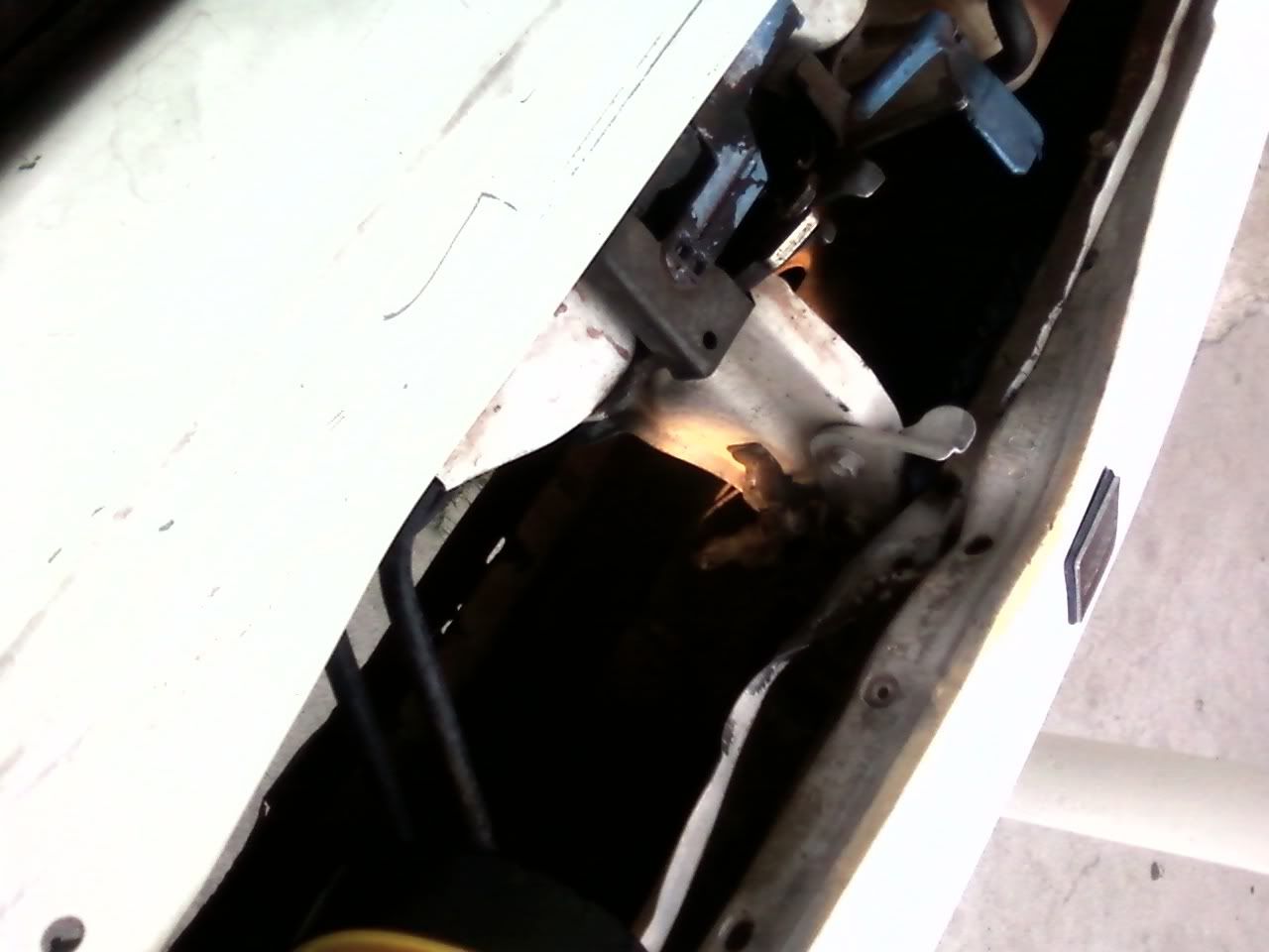

That's all of the locations iirc. I'm fairly sure you have to take out the turn signals, the grill piece, and the plastic fender wells to access all the bolts. It looks like someone took the foam supports out of your nose which is why it sagged like that.
You likely could fix it, but I doubt you'd be able to do it cleanly without respraying the nose. As for the metal bar it all depends on who you buy it from I suppose.
