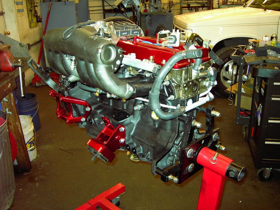

Adjuster
One plug, one bolt, and the right taps, and your there man. (I already had the taps and dies, so no big deal for me.)
The plug was cheap, but the bolt was about 6.00 IIRC. (Plug was like .80 cents.)
Here is a photo of the backside of my head. I just plugged the EGR port on the upper intake manifold, and it's done.

What? If you machine your own plates its being cheap.....:icon_conf
How do you think products are made?......by little supra faries that have more skills than people........
Now don't get me wrong, I'm NOT saying geto rig it, but look at pics of my bay and say I "cheaped out" by doing things myself.
EDIT: Nice ninga edit s383mmber1........
EDIT 2: Adjuster shows the best way to do it.
