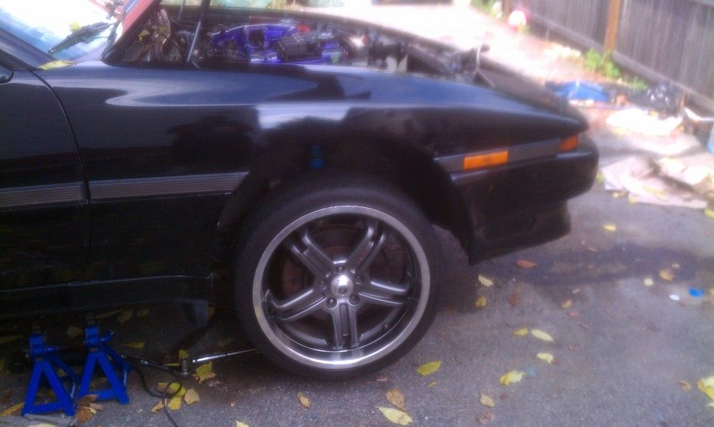

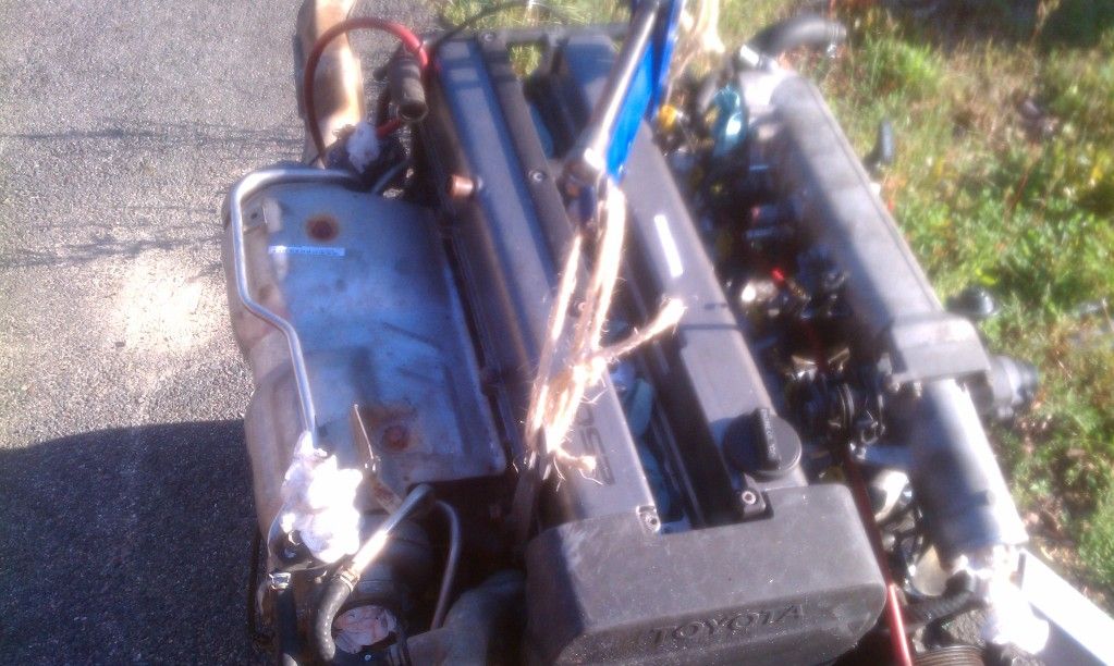

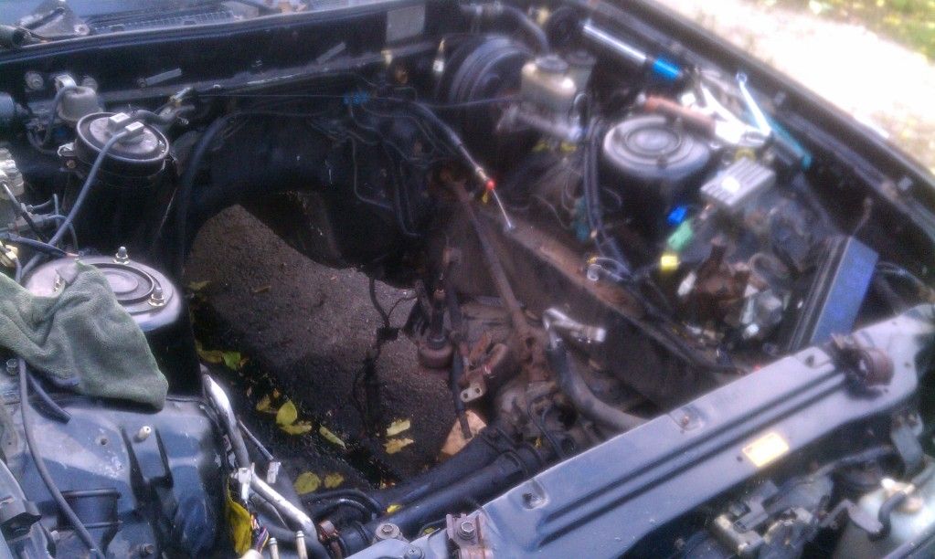

some updates, almost had a miss hap when pulling the engine, forgot to take the shifter out and realized when the engine was halfway out lol (im used to FWD dont have to pull the shifter) other than that i have an empty engine bay and alot of parts that will go for sale so check the forsale thread.

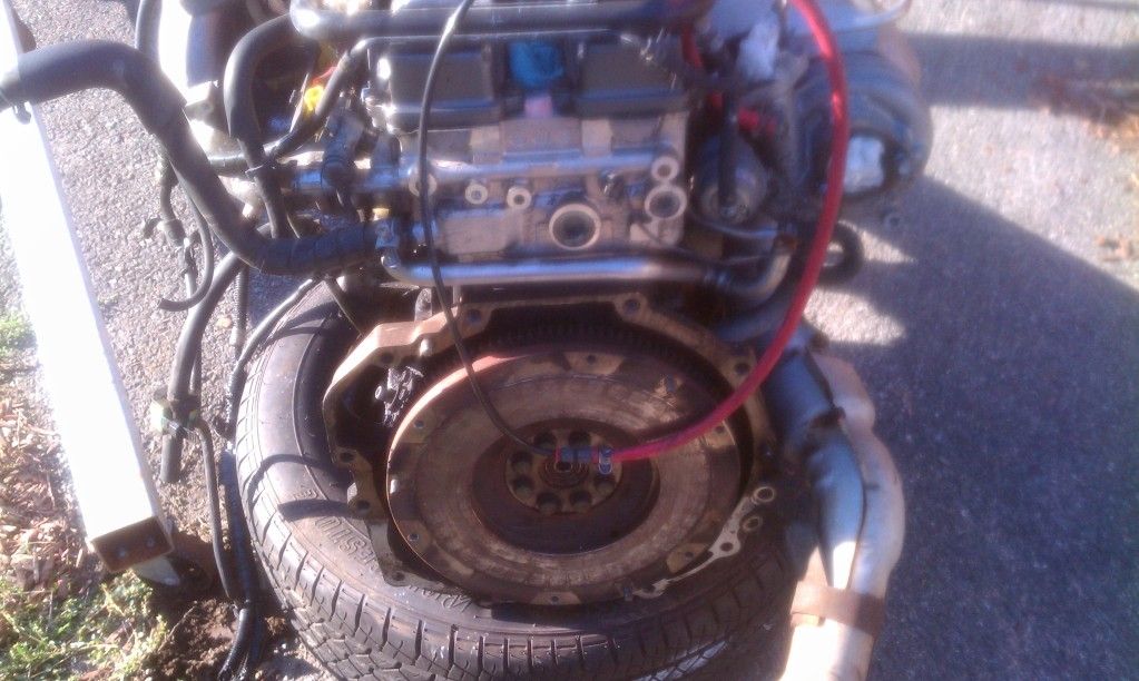

so now am just waiting on a few parts to arrive, meanwhile ill send the flywheel to get machined and possibly shaving some weight? (dont kill me guys i have read some threads outside of supra mania, and most of it was opinionated, so if anyone has actual experience PLEASE STOP ME NOW lol)
so now im going to work on some rerouting of the body harnes and the fuse box, also deleting the the AC lines and some other stufffffffffff, also laying a fresh coat of paint
if anyone has any advice on anything cool i can do to the engine bay before i drop the engine like 2 weeks from now ill appreciate it
and now some pics of what i did today

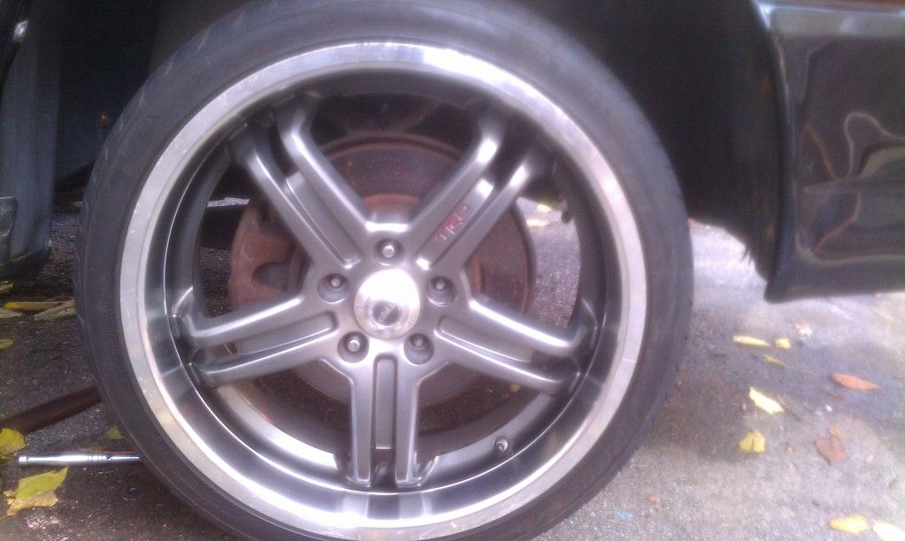

any thought on these rims they were on my scion xb, i may have to put them on the supra till i find something better
thats my friend Harry
again my friend Harry in the pic

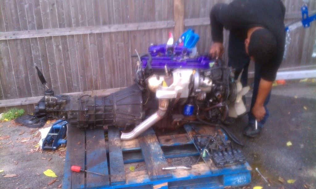

the 1jz as it sits now

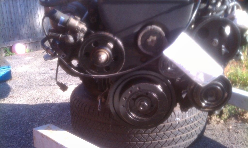

things to do to the 1jz before it goes in
-light wire tuck/extension on harness
-Lightweight Underdrive Pulley Kit V2.0 T6061 from DM
-water pump
-timing belt
-removing AC compressor (or as another member said, cannibalizing it) gotta keep the bracket i read somewhere

don't use a lightweight pulley on the crank, only use stock OEM crank damper, ATI, or Fluidamper. I haven't heard much on the last, I only know that the ATI units are really good
