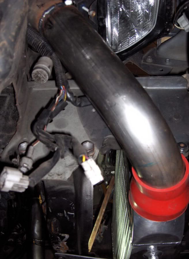

yup
customer did not want to pay for powder coating
It is often thought that *I* am making the part low quality. However, I am trying to meet the demand of the customer. The customer wanted the CHEAPEST solution possible, and that is what I provided.
If it was not powder coated, I would normally paint the pipes. However, he said he would powder coat later, so I left it raw. The day the kit was made, it also rained, so surface rust on mild steel happened near instantly.
Piping, black re-inforced couplers, clamps, IC, brackets, all as a bolt on easy install.

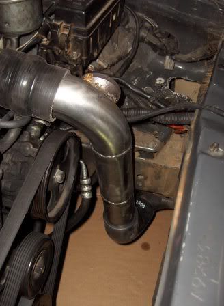

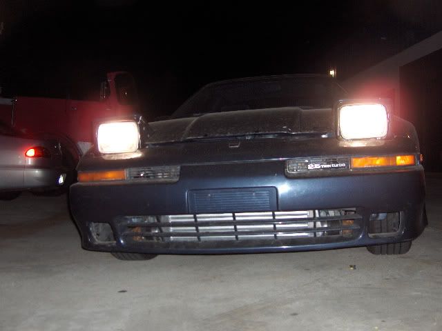

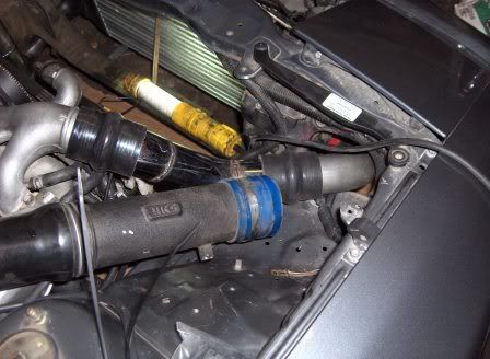

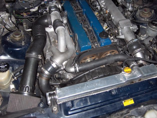

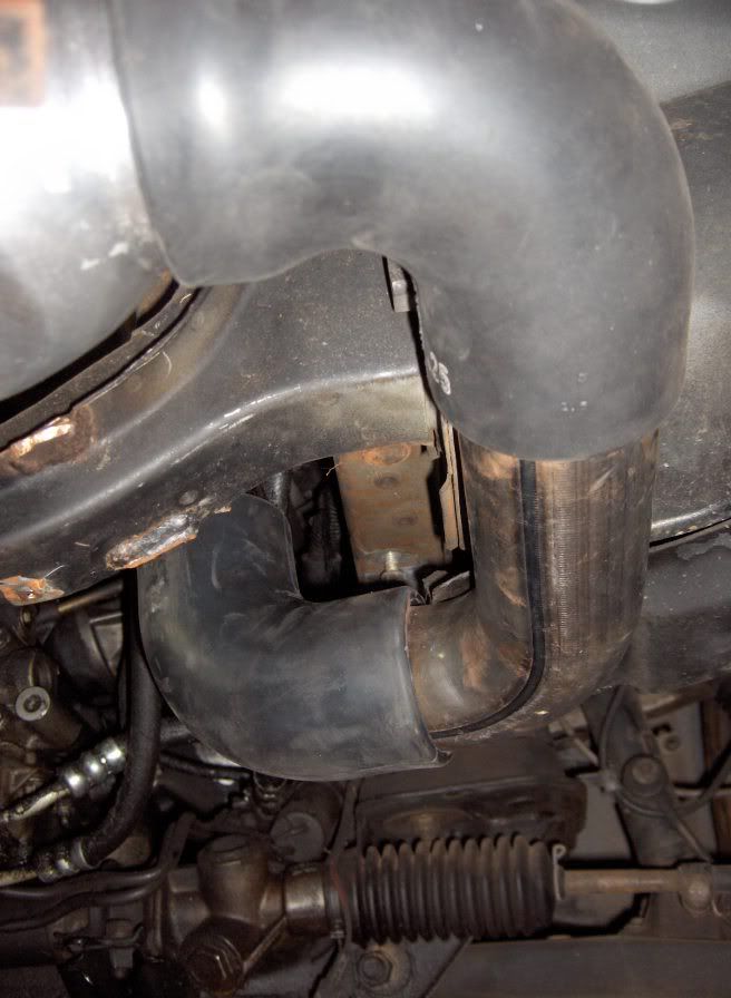

Another customer:
This one was also $500 installed. This customer planned to go single, so this piping was made to go through the airbox hole and such that he could easily change to single without re-doing the piping.
Turbo to airbox hole:
airbox hole to IC:
IC to TB pipe:
TB pipe w/ SSQV flange installed:

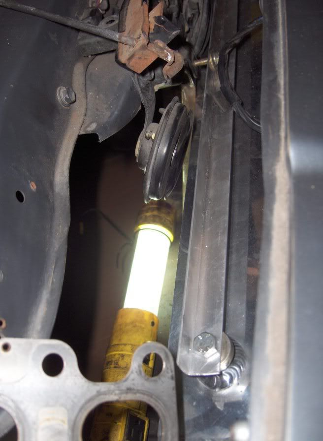

Lower Bracket:
Upper Bracket:

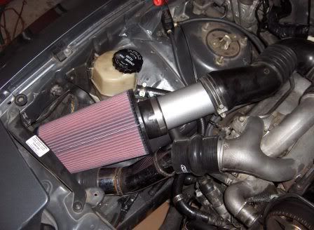

Since the HKS intake does not work with piping going through the airbox hole, a new intake was quickly fabbed up with K&N filter and adapter pipe. Cost $60 total:
