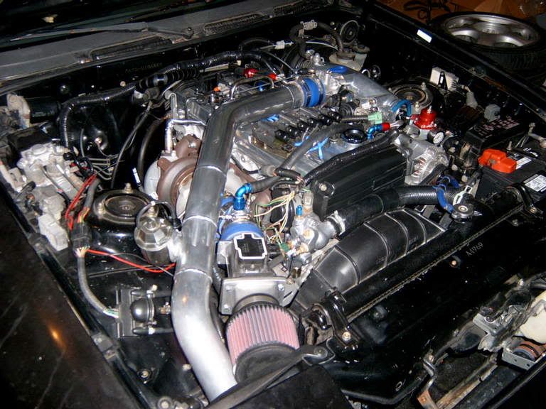

I made my own, but with the afm and couplers connected it was a little long, so i had to use a smaller filter. Heres a pic.
here is what I used:
(1) 45 degree 3 inch aluminum madrel bend(I cut out a small section of the bend) - $25
(1) 90 Degree -AN 10 to 5/8 Barb Earls fitting - $25.00
(1) -10AN male weld bung $8.00
(1) 3in coupler $4.00
(1) 3in to 3.25 reducer $18.00
Total spent - $80.00
