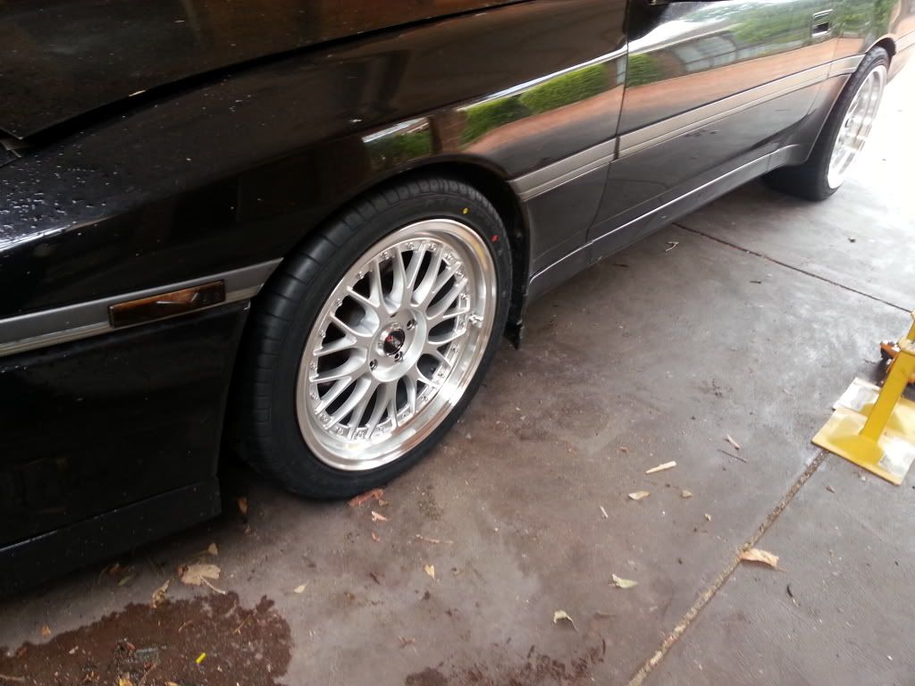

XXR521 wheels, 8.5’ front 10’ rear.

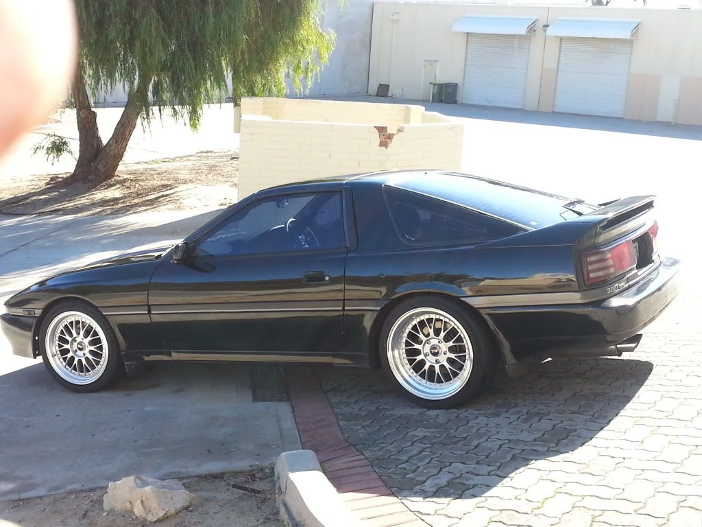

do you need to run 18's to clear your brake set-up? btw i like how you had 3 different pairs of rims on it in that short while haha, my car's had the same shoes for about 5 years now. I really want a pair of advan racing v1's I found some too but I have so many other things to buy that come first I find lol
Aleo24
Aug 15, 2011
71
Perth
Yeah 18's are needed for the front. I managed to fit my JZA80 16" over the rears so i can use my Et Streets at the local drag strip.

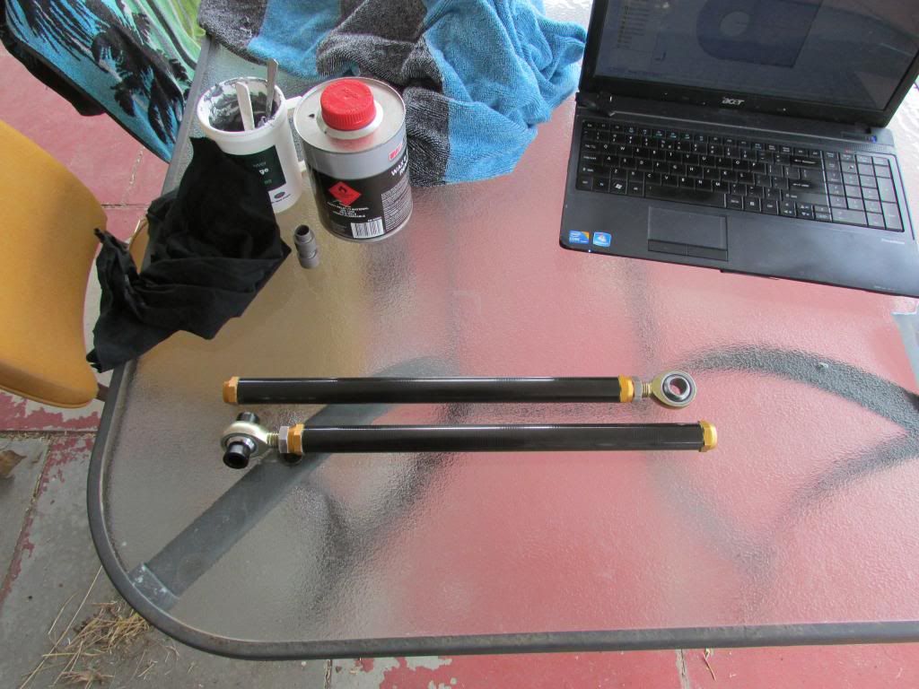

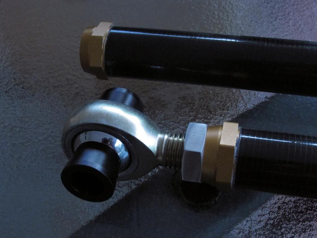

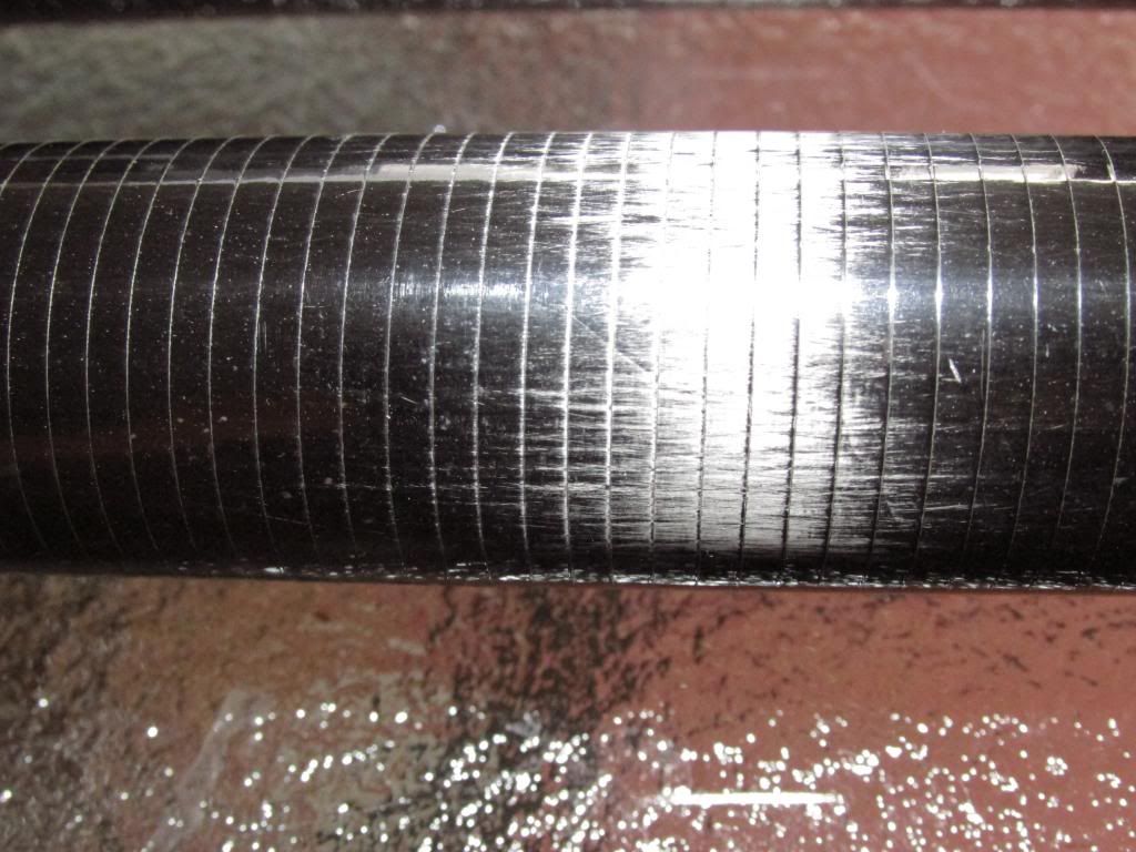

Some quick shots of my carbon fibre traction arms. Just waiting on the end links to come in, should be around 9th of next month.

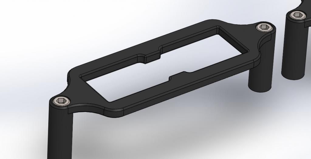

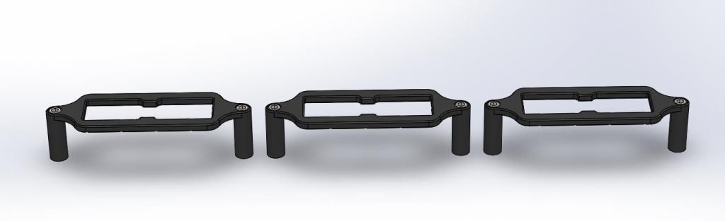

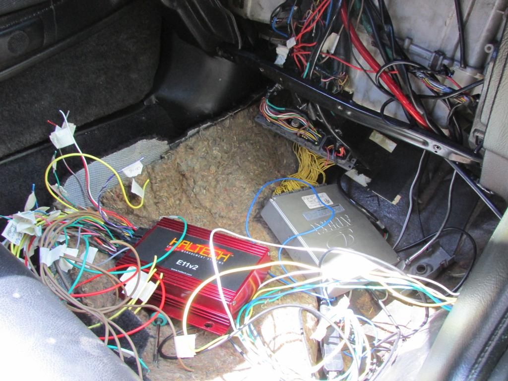

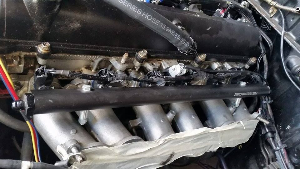

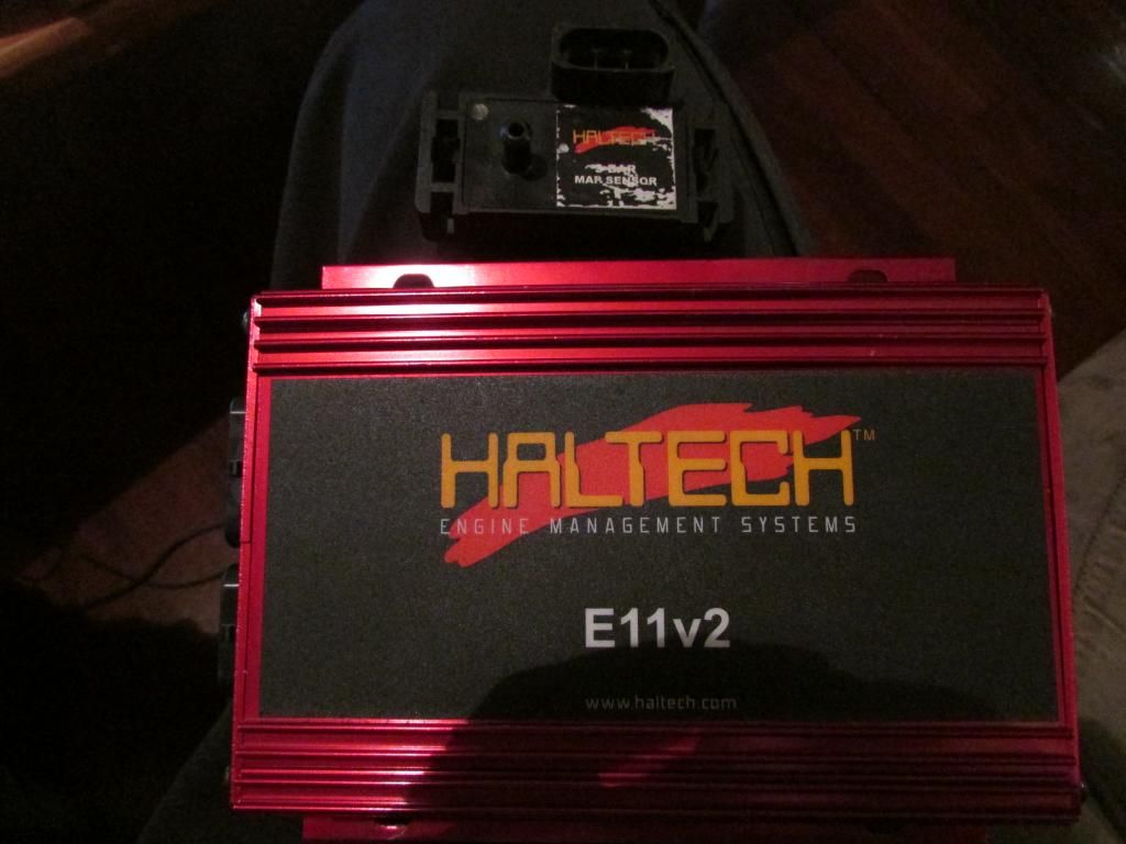

Got the opportunity to upgrade my ecu with a haltec E11V2, ive been trying not to spend money on the car till after my Japan trip in January but i couldn't pass up on this deal.
Decided to wire in some D585 coils while i was at it as i was getting ignition breakup at 23psi and higher.
And getting a local business to machine me up some brackets for the D585 coils
Aleo24
Aug 15, 2011
71
Perth

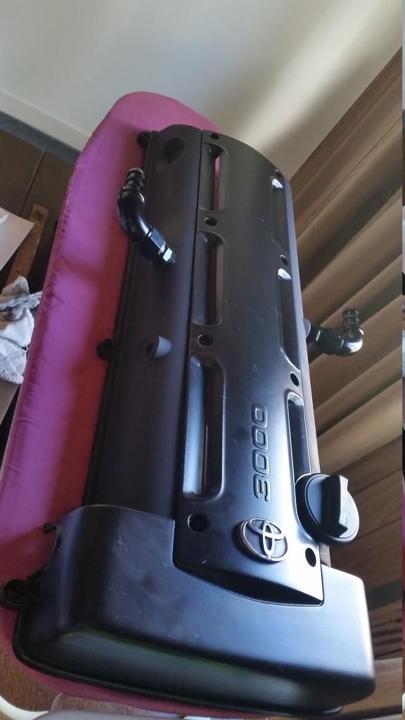

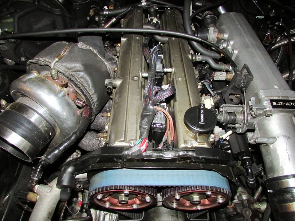

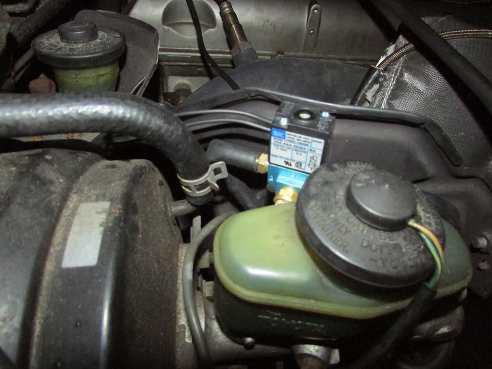

New boost control setup.
Coils mounted
New cam cover setup

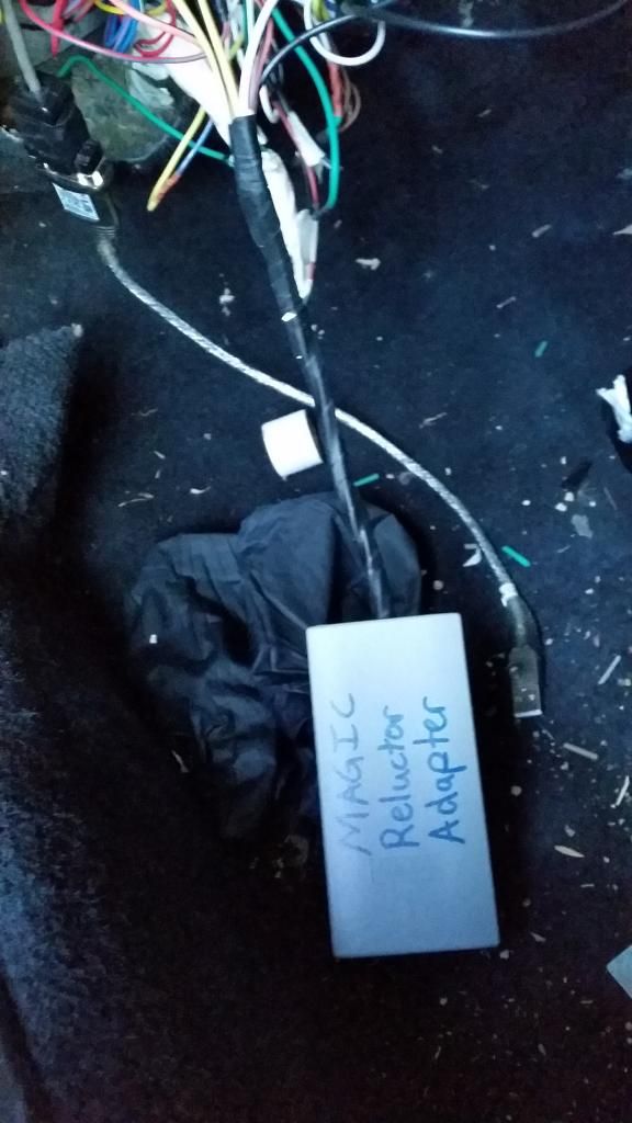

And reluctor box to get a clean signal for the haltec E11v2. The internal reluctor adapter doesnt seem to work too well.

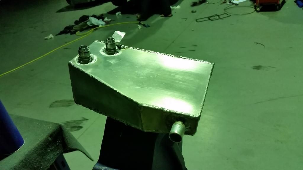

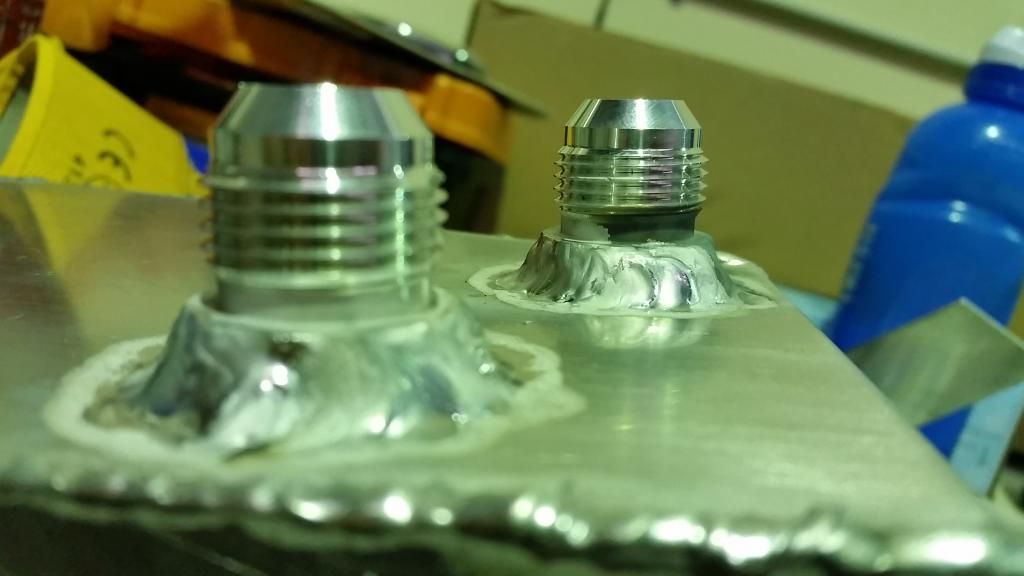

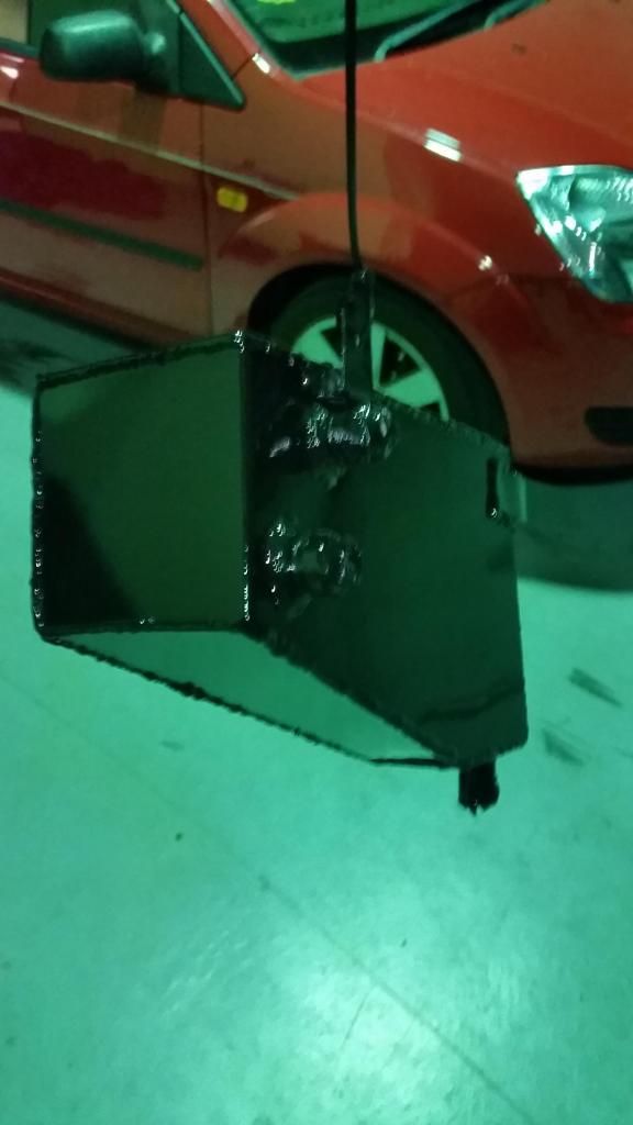

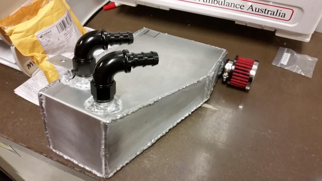

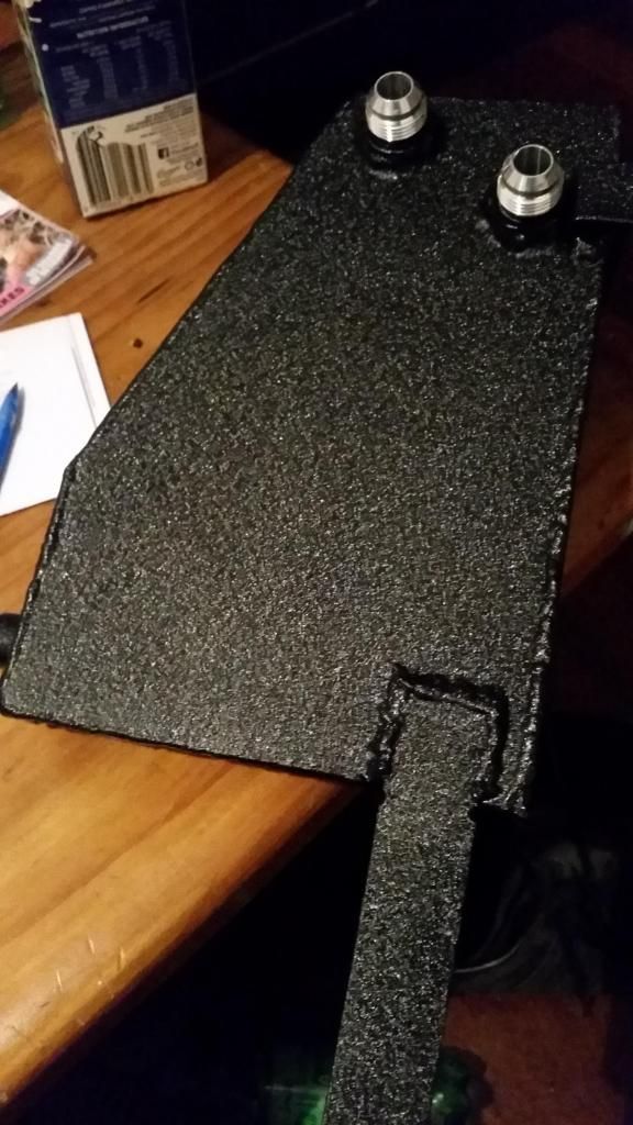

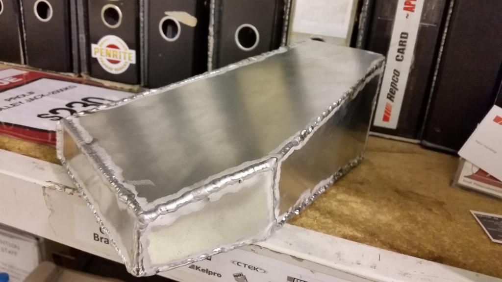

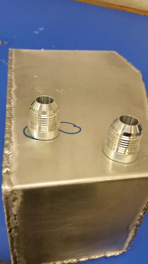

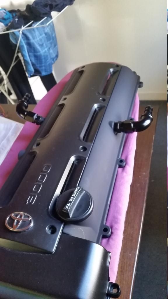

Had a crack at welding up an aluminium catch can. First time welding with AC tig and was quite a different experience compared to mild and stainless. Outcome was pretty good and fitment seems good. Will be fully installed once my last two fittings arrive. Didnt get many photos while welding and making the body. Luckily i had alot of help from a mate
The can
Mocking up for brackets
Fitting location
Welded Fittings
Bracket and breather
Painting
Aleo24
Aug 15, 2011
71
Perth
Cheers, the VHT wrinkle black hides some of the imperfections in the welds and makes it look a bit tougher.

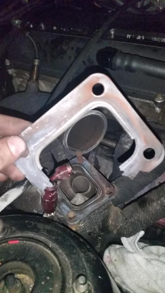

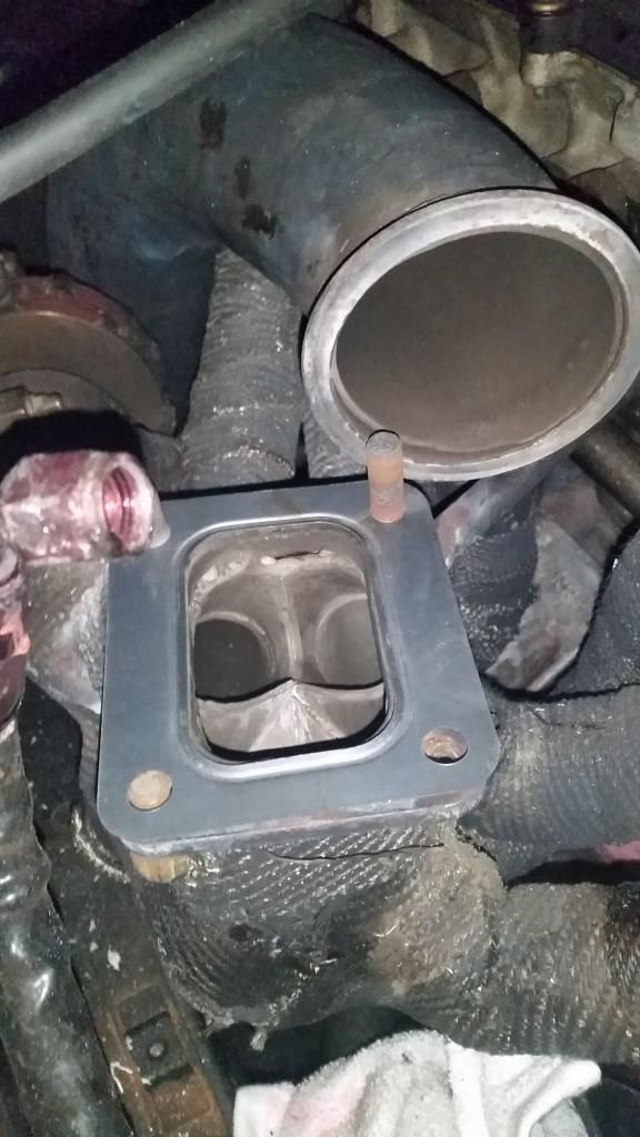

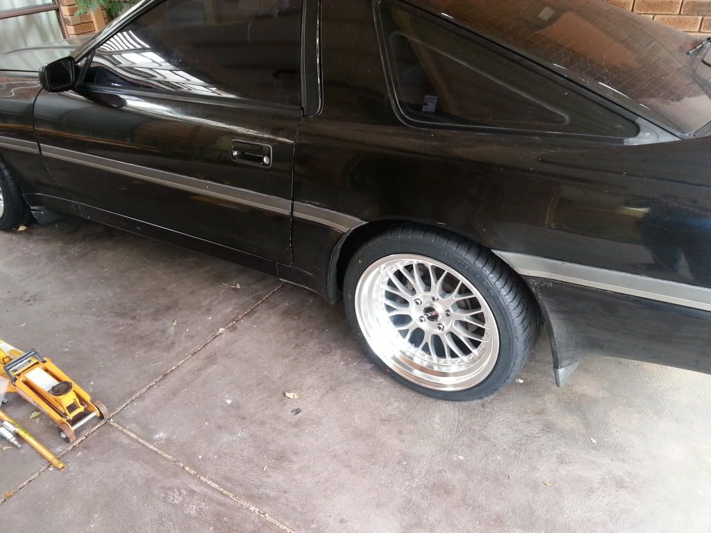

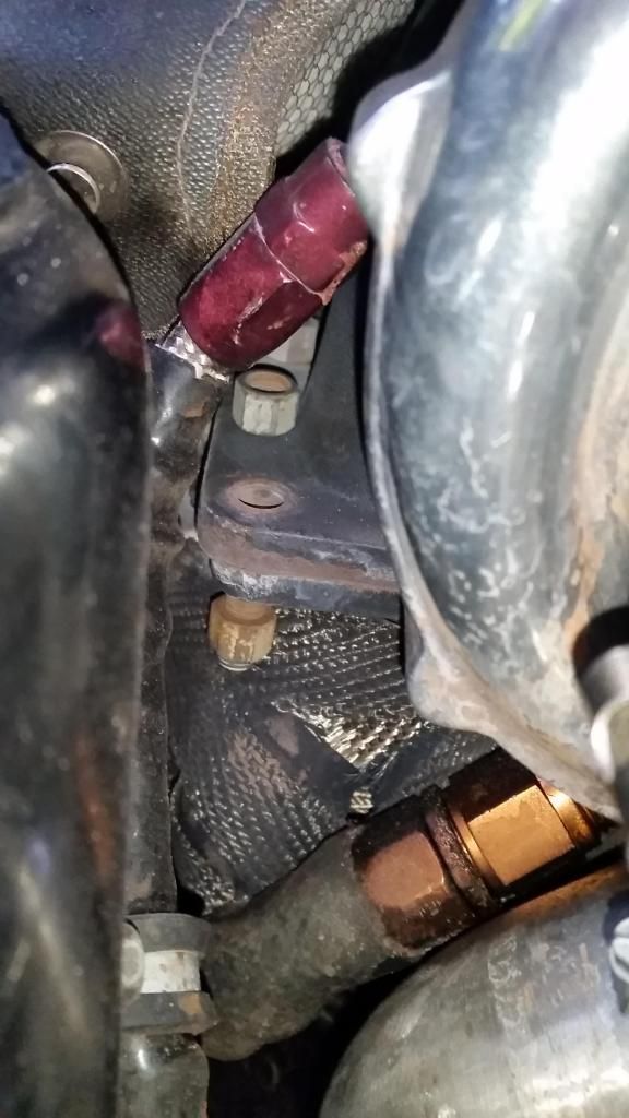

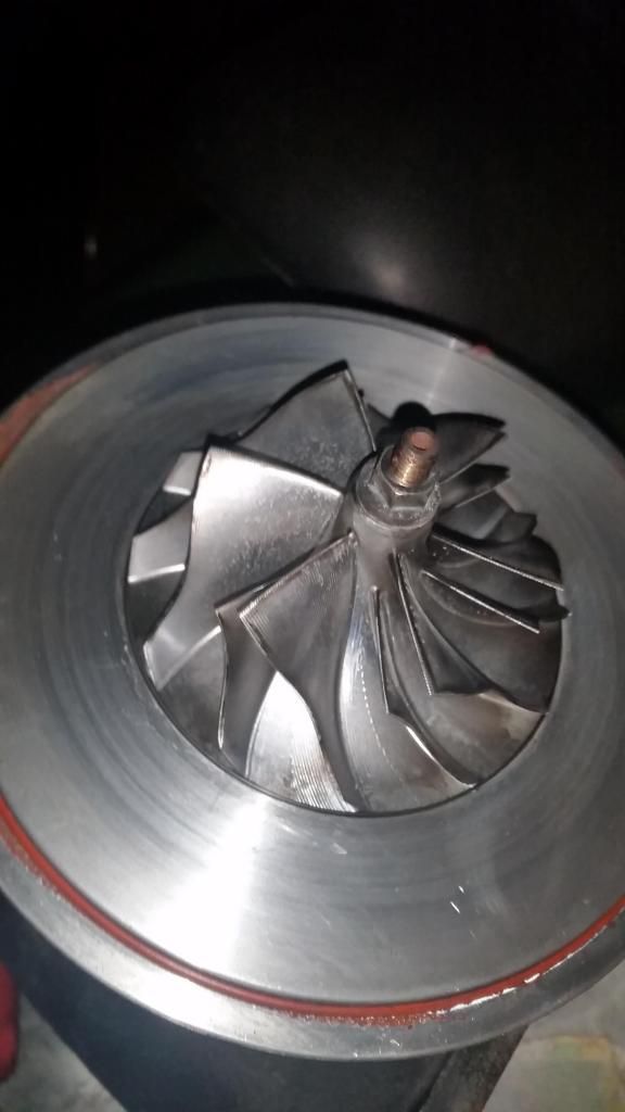

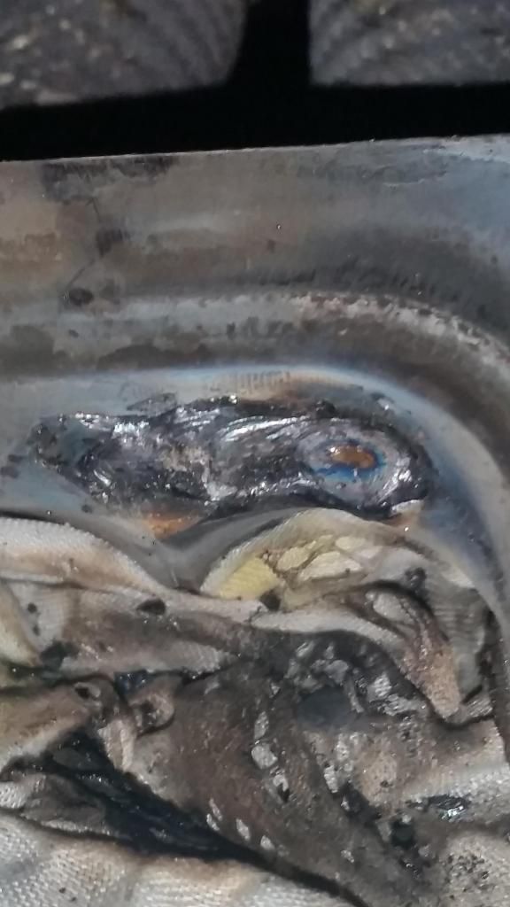

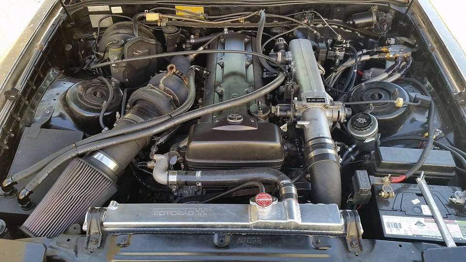

Yep here we go, tires are 245 on a 8.5" rim front, 265 on a 10" rim rear. +25 offset all round.
Also had a blowout with my turbo gasket and in the process found a hole in my manifiold. So a quick fix and im now getting 21psi at 3800rpm instead of 4100rpm. Comes on much stronger to the point im now looking into running some stickier tires. Being steered towards Hankook Z222.
Turbos still looking good after 2 years.
Latest look

Have you got a little quarter panel roll/pull to fit the 10" +25? I fit a 9" +25 nicely with a roll only...
Aleo24
Aug 15, 2011
71
Perth
I rolled the rear guards. Im only running a 265 tire so that gives a bit more room, will be moving up to a 285 tire and should still have enough clearance.

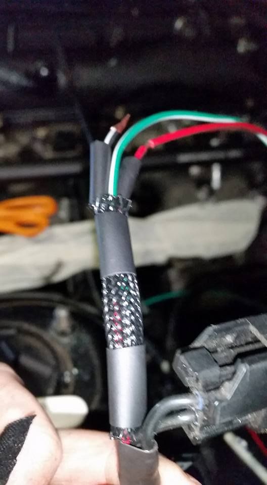

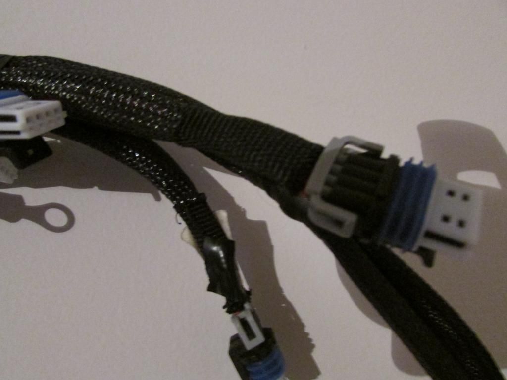

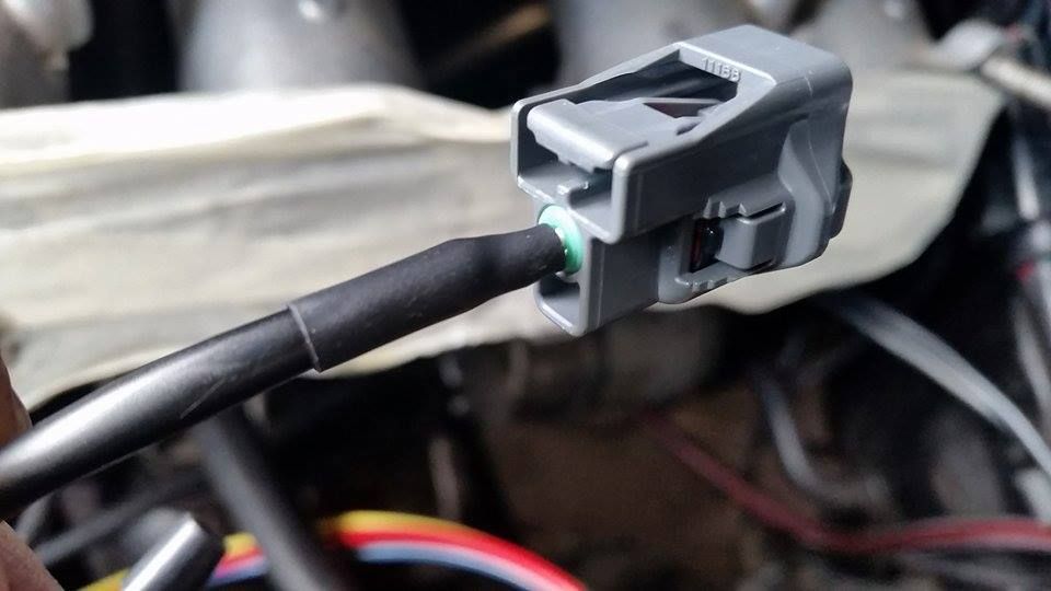

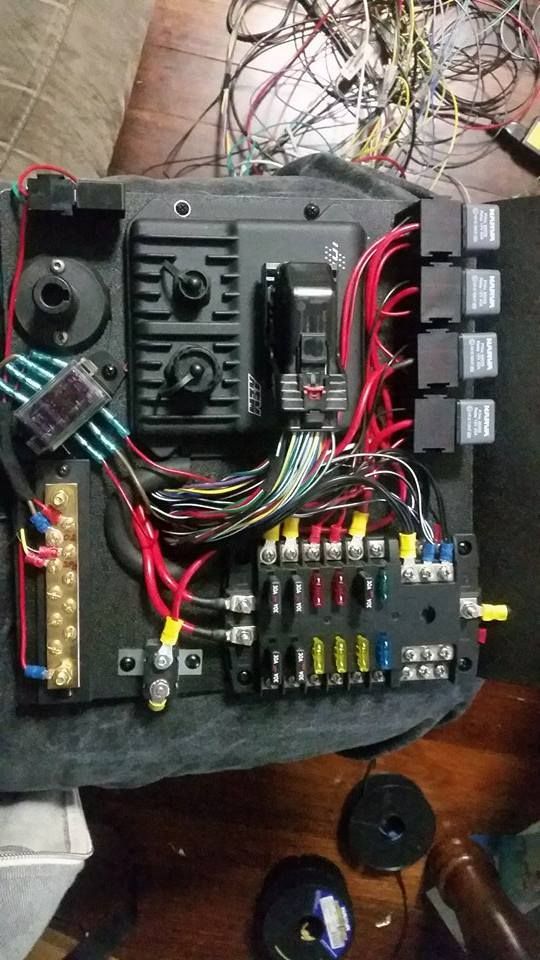

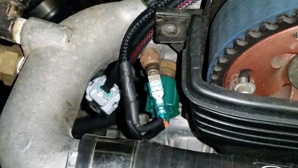

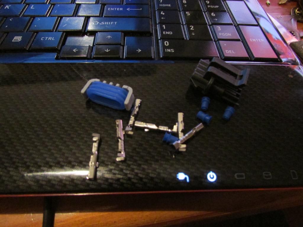

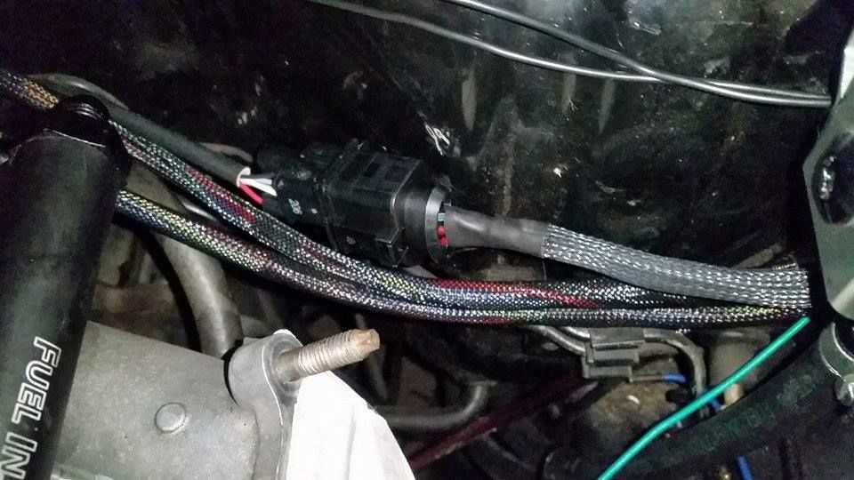

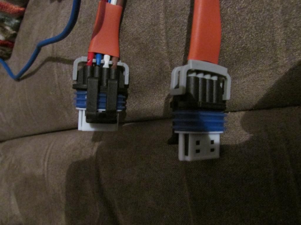

Cars had a fair bit of work done in regards to the wiring and tune up.

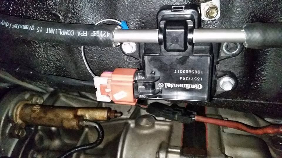

Got a rediculous deal on an AEM infinity and due to some shipping errors got sent a brand new unit. Wired it all in with new plugs from wiring specialties and added honeywell fuel pressure, oil pressure, oil temp (gotta weld a fitting to the sump) and a continental fuel flex sensor.
Got it all running on the basemap and was quite surprised how well it is after i put all my injector values in.
Wiring my ecu panel and engine harness.
Vid of it first running on the basemap.
http://vid1189.photobucket.com/albums/z430/Aleo24/video-1441359763.mp4_zpstiilnhr2.mp4
Tunes almost finished now, the logging and software make it very easy to diy tune.
