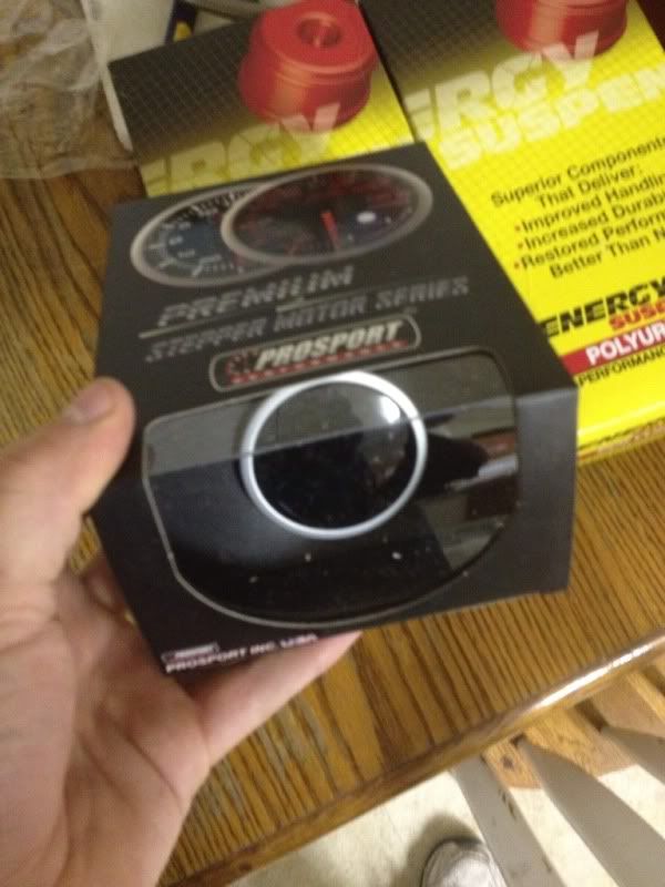

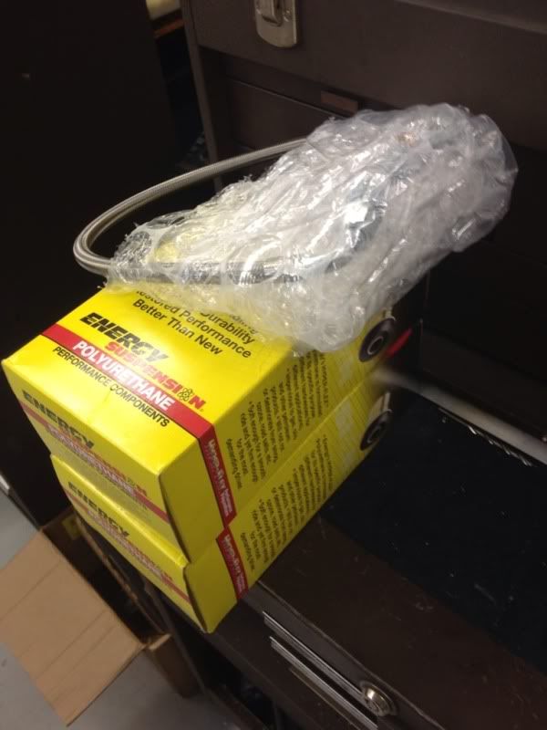

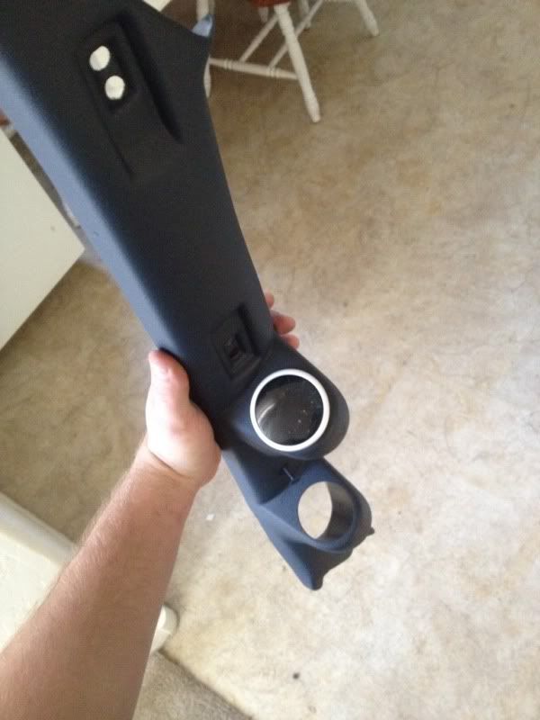

Just ordered Energy Bushings for front and rear.
and a LoTEK 2 gauge pod pillar
oh and a Blue/White Prosport boost gauge
