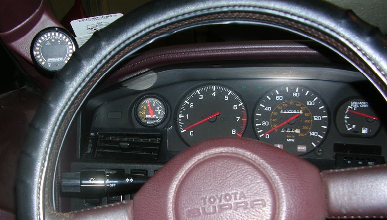

The only thing I don´t like is the fact that you can quite obviously see that you did some grinding on the cluster.
I like RonR´s version a lot! However, as of today I don´t know which kind of gauge he actually put in... :(

Ron has a MoTeC Dash

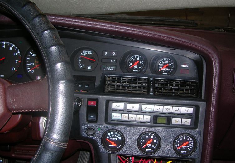

Not to shabby, go for the temp gauge while you got it out:thumbup:
And I would make to where you like it, or else your not gonna take you eyes off the flaws.
